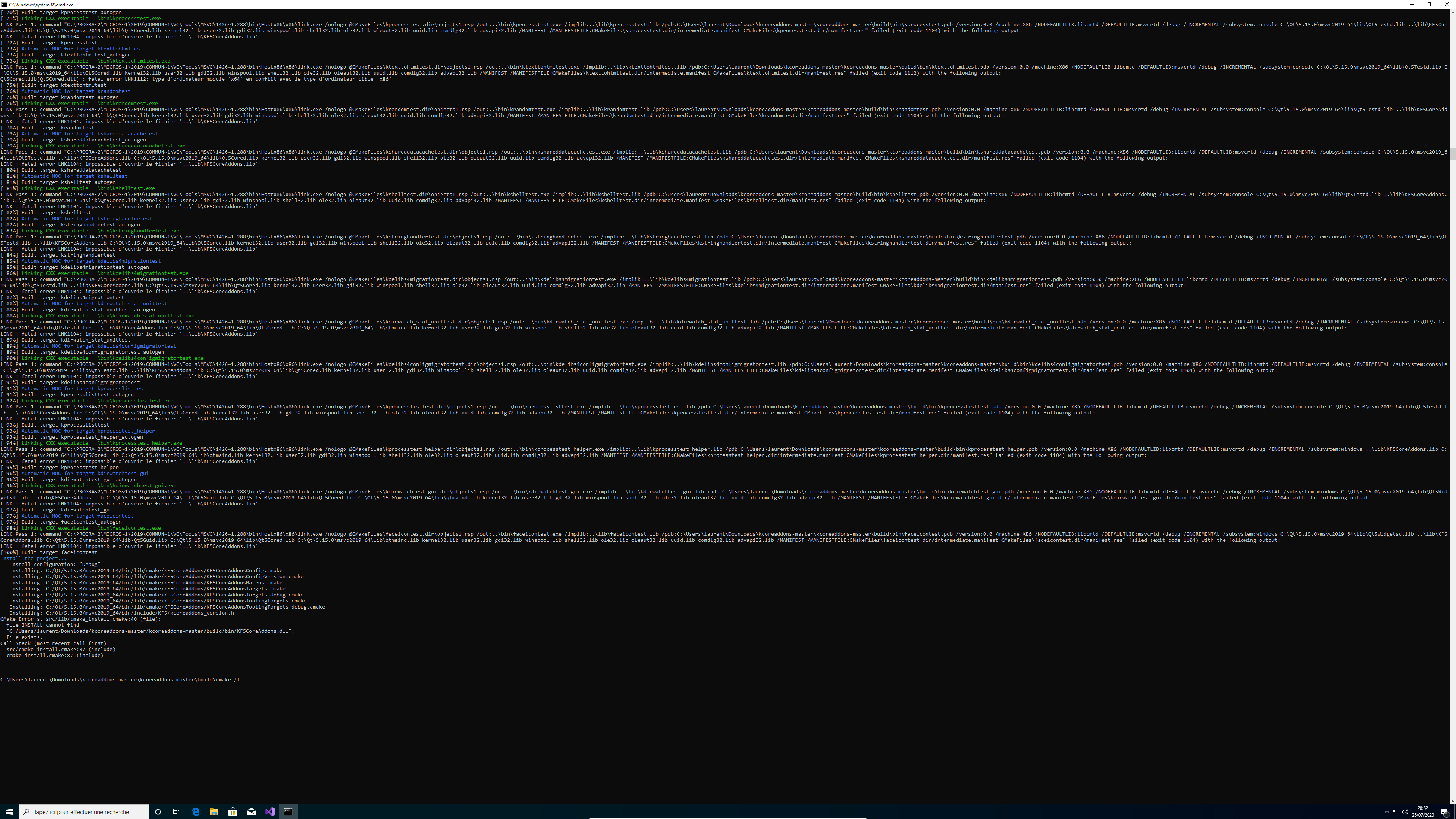

Humm try to compile with visual studio 2019 under Win10 ..
https://github.com/drawpile/Drawpile/wi … om-sources
[ 18%] Building CXX object src/lib/CMakeFiles/KF5CoreAddons.dir/text/kmacroexpander_win.cpp.obj
[ 19%] Building CXX object src/lib/CMakeFiles/KF5CoreAddons.dir/util/klistopenfilesjob_win.cpp.obj
[ 19%] Building CXX object src/lib/CMakeFiles/KF5CoreAddons.dir/util/kprocesslist_win.cpp.obj
[ 20%] Building CXX object src/lib/CMakeFiles/KF5CoreAddons.dir/util/kshell_win.cpp.obj
kshell_win.cpp
[ 20%] Building CXX object src/lib/CMakeFiles/KF5CoreAddons.dir/util/kuser_win.cpp.obj
kuser_win.cpp
[ 21%] Building CXX object src/lib/CMakeFiles/KF5CoreAddons.dir/ECMQmLoader-kcoreaddons5_qt.cpp.obj
[ 21%] Building CXX object src/lib/CMakeFiles/KF5CoreAddons.dir/kcoreaddons_debug.cpp.obj
[ 22%] Linking CXX shared library ..\..\bin\KF5CoreAddons.dll
LINK Pass 1: command "C:\PROGRA~2\MICROS~1\2019\COMMUN~1\VC\Tools\MSVC\1426~1.288\bin\Hostx86\x86\link.exe /nologo @CMakeFiles\KF5CoreAddons.dir\objects1.rsp /out:..\..\bin\KF5CoreAddons.dll /implib:..\..\lib\KF5CoreAddons.lib /pdb:C:\Users\laurent\Downloads\kcoreaddons-master\kcoreaddons-master\build\bin\KF5CoreAddons.pdb /dll /version:5.73 /machine:X86 /debug /INCREMENTAL C:\Qt\5.15.0\msvc2019_64\lib\Qt5Cored.lib netapi32.lib userenv.lib kernel32.lib user32.lib gdi32.lib winspool.lib shell32.lib ole32.lib oleaut32.lib uuid.lib comdlg32.lib advapi32.lib /MANIFEST /MANIFESTFILE:CMakeFiles\KF5CoreAddons.dir/intermediate.manifest CMakeFiles\KF5CoreAddons.dir/manifest.res" failed (exit code 1112) with the following output:
Qt5Cored.lib(Qt5Cored.dll) : fatal error LNK1112: type d'ordinateur module 'x64' en conflit avec le type d'ordinateur cible 'x86'
NMAKE : fatal error U1077: '"C:\Program Files\CMake\bin\cmake.exe"' : code retour '0xffffffff'
Stop.
NMAKE : fatal error U1077: '"C:\Program Files (x86)\Microsoft Visual Studio\2019\Community\VC\Tools\MSVC\14.26.28801\bin\HostX86\x86\nmake.exe"' : code retour '0x2'
Stop.
Stop.
Re: QElectrotech is freezing / loading time library elements
Ok, fixed..
nmake /I
nmake  install /I
