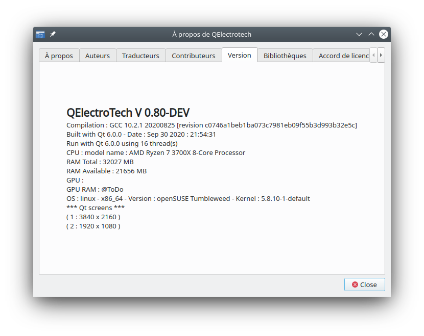

71 Issues for built on qt6  nomicons/unsure
21:56:36.292 Info: Start-up
21:56:36.305 Info: debugging enabled: false
21:56:36.305 Info: Qt library version: 6.0.0
21:56:36.305 Info: Qt library location default prefix: "/home/simon/Qt/6.0.0/gcc_64"
21:56:36.306 Info: Qt library location documentation: "/home/simon/Qt/6.0.0/gcc_64/doc"
21:56:36.306 Info: Qt library location headers: "/home/simon/Qt/6.0.0/gcc_64/include"
21:56:36.306 Info: Qt library location libraries: "/home/simon/Qt/6.0.0/gcc_64/lib"
21:56:36.306 Info: Qt library location executables: "/home/simon/Qt/6.0.0/gcc_64/libexec"
21:56:36.306 Info: Qt library location Qt binaries: "/home/simon/Qt/6.0.0/gcc_64/bin"
21:56:36.306 Info: Qt library location Qt plugins: "/home/simon/Qt/6.0.0/gcc_64/plugins"
21:56:36.306 Info: Qt library location installed QML extensions: "/home/simon/Qt/6.0.0/gcc_64/qml"
21:56:36.306 Info: Qt library location dependent Qt data: "/home/simon/Qt/6.0.0/gcc_64"
21:56:36.306 Info: Qt library location independent Qt data: "/home/simon/Qt/6.0.0/gcc_64"
21:56:36.306 Info: Qt library location translation: "/home/simon/Qt/6.0.0/gcc_64/translations"
21:56:36.307 Info: Qt library location examples: "/home/simon/Qt/6.0.0/gcc_64/examples"
21:56:36.307 Info: Qt library location Qt testcases: "/home/simon/Qt/6.0.0/gcc_64/tests"
21:56:36.307 Info: Qt library location Qt settings: "/home/simon/Qt/6.0.0/gcc_64/etc/xdg"
21:56:36.307 Info: "GitRevision 930bb70f99d5fd160804e43aa677e72745a5f30d"
21:56:36.307 Info: "QElectroTech V 0.80-DEV"
21:56:36.307 Info: "Compilation : GCC 10.2.1 20200825 [revision c0746a1beb1ba073c7981eb09f55b3d993b32e5c]"
21:56:36.307 Info: "Built with Qt 6.0.0 - Date : Sep 30 2020 : 21:54:31"
21:56:36.307 Info: "Run with Qt 6.0.0 using 16 thread(s)"
21:56:36.307 Info: "CPU : model name\t: AMD Ryzen 7 3700X 8-Core Processor\n"
21:56:36.307 Info: "RAM Total : 32027 MB"
21:56:36.307 Info: "RAM Available : 21694 MB"
21:56:36.307 Info: "GPU : "
21:56:36.307 Info: "GPU RAM : @ToDo"
21:56:36.307 Info: "OS : linux  - x86_64 - Version : openSUSE Tumbleweed - Kernel : 5.8.10-1-default"
21:56:36.307 Info: *** Qt screens ***
21:56:36.307 Info: "( 1 : 3840 x 2160 )"
21:56:36.307 Info: "( 2 : 1920 x 1080 )"
21:56:36.624 Info: Elements collection reload
21:56:36.630 Info: Elements collection finished to be loaded
12
Re: Qt 6.0 development and qelectrotech
With ~ 7000 elements in official collection?
6 ms?
13
6 ms?
sharp eye, no, one of the Issues
14
6 ms?
no elements in /usr/share/
add in run works
--common-elements-dir="...../qet/elements/"

23 (edited by De-Backer 2020-10-03 21:51:52)
I would drop the support, Suse is also not supported (and I use it)
but we must get rid of KWidgetsAddons KCoreAddons (this makes it difficult to compile)

Yes is sometime very difficult, I don't know what changes on brew KF5 or in  https://invent.kde.org/frameworks/kcore … ts/master/ but I finished to upgrade and compile fine with Qt 5.15.1 + frameworks 5.74 on OSX .. I had to copy KF5 include and libs to Cellar/Qt .. otherwise he does not find  the #include <KAutoSaveFile> path ..
https://forum.qt.io/topic/75081/qmake-m … r-karchive
https://download.qelectrotech.org/qet/forum_img_2/osx_qt5.15.1.png
Now wait MXE python2 to python3 changes to upgrade to Qt 5.15.1 for Windows cross-compile packages, Debian removed Python2 support in unstable https://github.com/mxe/mxe/issues/2561
https://github.com/mxe/mxe/issues/2561# … -692811705
