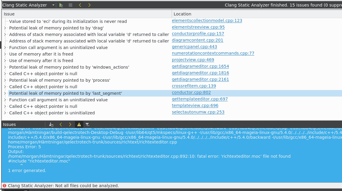

Until then, clang do think there are at least potential problems with Qet code.  Have you checked?
( I am no programmer of this kind, so do not know much about it... just playing with the tools...)

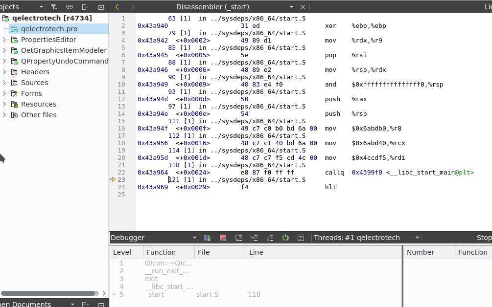

Another crash at saving document after i saw that a conductor did not get properly deleted.
As i see it we have at least two problems
1) something goes wrong in the in-memory drawing
2) it crash when/after saving a drawing with the the in-memory drawing
It is interesting and lucky that the saved drawing is OK
The debugger seem unable to spot 1)
And when crashing i only see dissassembly - not part of Qet source code?
Yes of course, and clang is very verbose.
It 's found ~ 45 warnings, only ~ 4 with GCC
Re: Development version occasionally crashes while editing schema
Ah, good nomicons/smile
