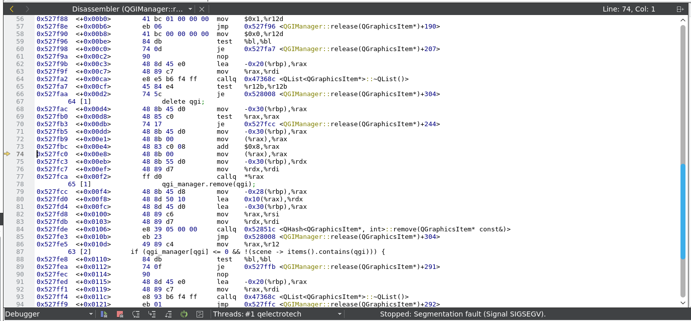

I had been editing elements and shema, then in schema editor i pressed the "diskette" button and Qet crashed.

In case it helps: screenshot of dissassembly

This may have been related to bug 107 (now fixed)

I can not repeat for r4771 and above :)
If no one else see this, please close fixed
