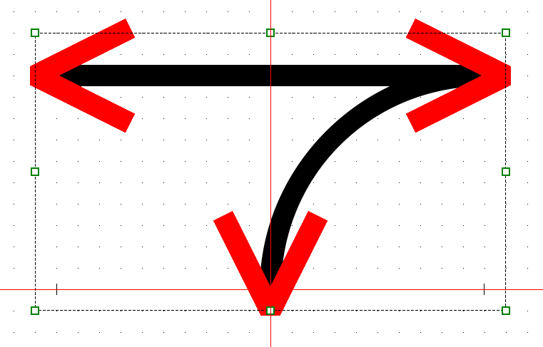

| Description | svn 4734, running in debug mode from QtDesigner I have a multipage schematic open I was editing a simple element originally only containing two arcs and the "label" field: 1) opened the element by doubleclicking it in schema editor collections pane 2) added three three-point polylines 3) selected all the three three-point polylines, and copied them using ctrl-c (with intention to copy them into other elements) 4) clicked the windows closing button (x) => segmentation fault 5) grabbed attached screenshot | ||||

It did save the element correctly despite crashing |
fixed in 4736 |
