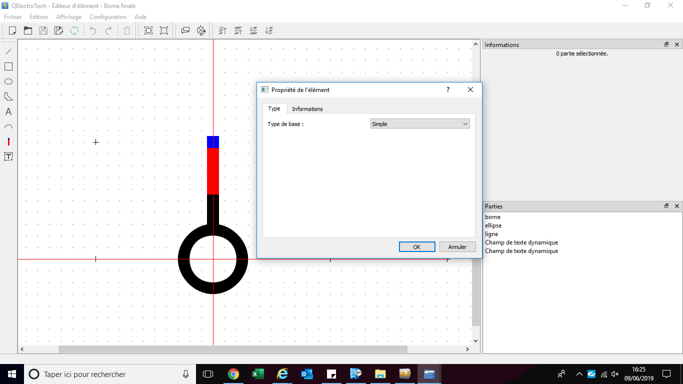

les bornes finales ne sont pas répertorier en tant que bornes.
de se fait elles se sont pas prisent en compte par le tb_generator
QElectroTech → Terminal block generator → Ideas to solve Terminal Blocks creation

Elements final terminals change link type simlple to terminal, thanks S.DEFFAUX to report it

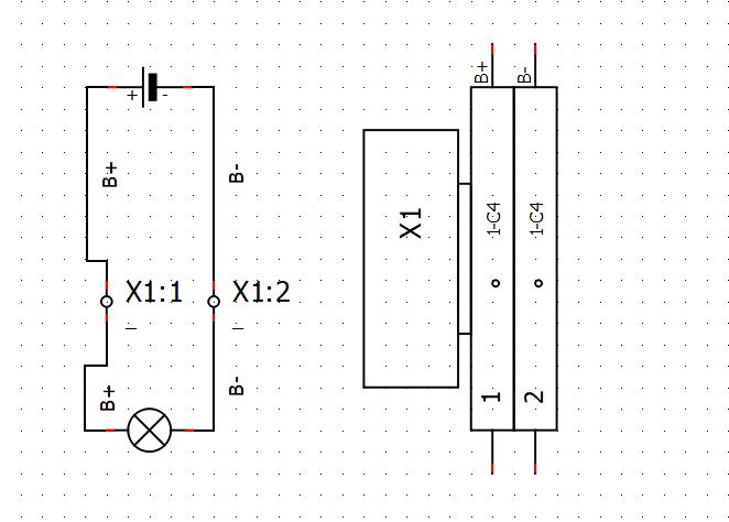

need help with with terminal block creation. I don't know how to generate terminal with conductor assigned at boottm. My elements (terminals) doesn't have Designation property to set them to "1,2". I am using latest plugin 1.0.16 on Windows 10.
Hello,
link your reports before generate terminal blocks plug-in and you will have wires names.
thanks for reply but I don't understand what are you trying to say. Can you be more specific ?
Hi
Example : https://download.qelectrotech.org/qet/s … 19.qet.pdf
I think I did everything ok in diagram attached in this post, but still no names.
Conductors connected on the same terminal can't have a different label name!
In principle QET does not allow it, and that is why the terminal block generator works badly in your example.
If I understand you wiring attached should work. But there are still no names at bottom side of terminals.

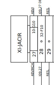

I introduce the version 1.0.15Changes:
* When the last terminal of a terminal block had defined a cable with a single conductor, it was not drawn. (thanks Jarosław)

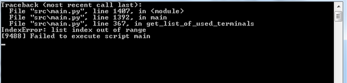

J'ai le même message d'erreur :
laurent@debian:~$ qet_tb_generator
File "/usr/bin/qet_tb_generator", line 11, in <module>
load_entry_point('qet-tb-generator==1.0.16', 'console_scripts', 'qet_tb_generator')()
File "/usr/lib/python3/dist-packages/src/main.py", line 1392, in main
qet_terminals_used = qet_project.get_list_of_used_terminals()
File "/usr/lib/python3/dist-packages/src/main.py", line 367, in get_list_of_used_terminals
terminalId2 = terminals[1].attrib['id']
IndexError: list index out of range
