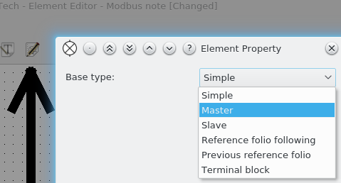

Is there already a trick to cross reference "anything"?
It would be nice to cross reference:
  • a coil on the electrical drawing, with the corresponding valve on the pneumatic or fluid drawing
  • a motor with its position and end travel sensors
  • a motor with its driven compressor/pump/fan
etc...
Linking a coil with valve is logically the same trick linking coil with switch, and as useful nomicons/smile
If such such general trick, do not exist i can probably copy/edit them into cross ref types...
I found the button in the Element editor (picture)
I think i figured out Master/Slave...
But how do we use the three lower types in dropdown list?
I have found some videos (not watched through all...) and also the documentation for version 0.4
Is there some unfinished somewhat usable documentation of later version?

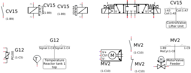

OK thanks that is one way to do it nomicons/smile
I want something less easy to foul up.
I have been experimenting with making master and slave symbols for representing the same part in elecric, pneumatic and mechanical drawing.
The way i think is that user and service personnel first look at the process drawing; the "big stuff" in the hall.
So i made the process parts master.
Say you have a process valve, operated pneumatically, and with electric feedback:
The valve is on process drawing, with a list of linked items positions, and annotation
On the electrical drawing are the valves position switches,
And on pneumatic drawing is the actuator part of the valve - and they all have same label nomicons/smile
Then there is the piloting/control valve that have its master part on pneumatic drawing, and coil on electric drawing.
I can also divide sensors in two parts: part with the measurement connection, and the electric connection part.
Or a valve with servo motor separated.
A 5/3 valve with two coils have naturally two coils in electric drawing.
Complex valves/actuators may have more tan one actuator and more than one feedback
I could have mechanical drawings too, floor plans where process parts locations are indicated...
Still playing and learning...

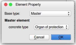

one question:
in your screenshot, process part on the right, why do you use some contact cross ref tables for the P.PV1 valve?
You obviously defined the element as "Master" and then as "coil".
Maybe you would rather defined the process elements like this:
crossref_organprotection.png, 15.84 kb, 317 x 190

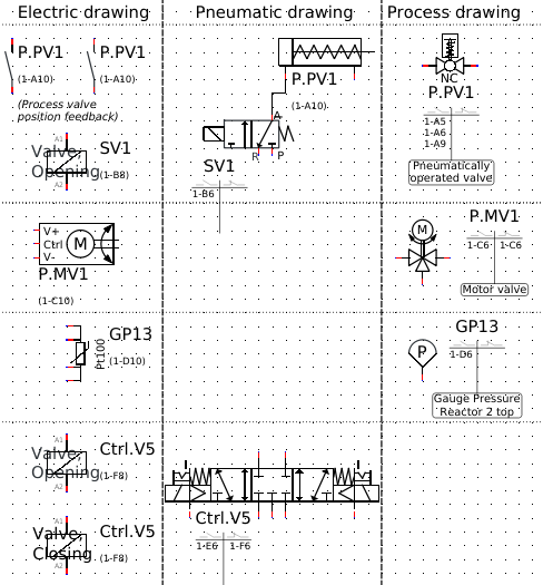

Re: (Edited) Making our own cross referencing symbols
Trick to make it list what kind of slaves it is:
Use the existing system to get prefixes in cross ref:
1) Set master elements to be type "Switch/button"
2) Set slaves to be Power or Delayed to be referenced like "Coil:" / "MoCyl:"
(and use NO or NC type switch depending on in which column you want it listed,
could be used for differentiating opening and closing valve pilot solenoids)
For "Signal:" use Normal type switch (change over) (it will always be listed in both columns)
3) Set up use of prefixes for "Switches":
Right click project in tree
  Project Properties
    New Folio
      Cross references
Type: select "Switches"
[x] show power contaxts in cross
Set prefixes:
Power contacts : "Coil:" (and set Coil slaves to identify as Power contact)
Delayed: "MoCyl:" (and set motor & cylinder to identify as Change Over contact)
Change Over: "Signal:" (and set sensors slaves slaves to identify as Delayed contact)
Auxiliary NO or NC contacts can still be used and do not get prefixes.
Little problems
1:
"Signal:" parts get listed in both crossref columns
2: An Aux change over contact get
"Signal:" prefix
3: I can not use Switches type master for anything else than Aux or they will get the prefixes
Screenshot_20161005_000522.png, 34.25 kb, 666 x 255

Let me explain by example what I really want.
See top row of the last screen-shot I posted above;
1)
On each slave i want to put a short visible descriptive label;
on the switch "sw top pos", on the valves "coil down" and "coil up" respectively.
I then want those texts to show up automatically at the master together with slave coordinates, like this:
sw top pos : 1-A3
coil down : 1-A5
coil up : 1-A7
2)
On the master i want to put a descriptive label like "Lifter Unit" optimally placed right below the main label, before xref list.  So now it looks like this:  (large typeface emulated by me using spaces)
 C V 1 5
Lifter unit
sw top pos : 1-A3
coil down : 1-A5
coil up : 1-A7
... I then want all connected slaves to display that description too, i.e for the switch placed like this:
 C V 1 5
Lifter Unit
1-B9
Edit to make it visually complete:
As said at 1) above the switch also show:
sw top pos
/Edit
