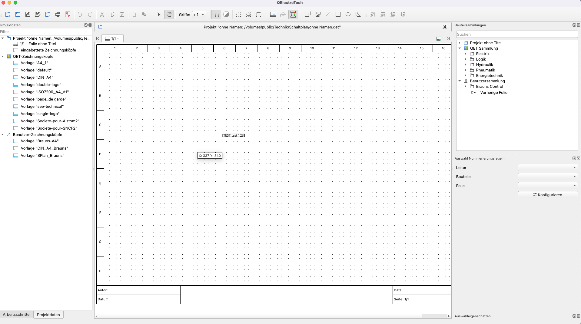

sry for the late reply, but here is an example with the file and screenshots from MacOS and Manjaro
screen-macos.png, 164.15 kb, 1918 x 1070
screen-manjaro.png, 149.69 kb, 2050 x 1158

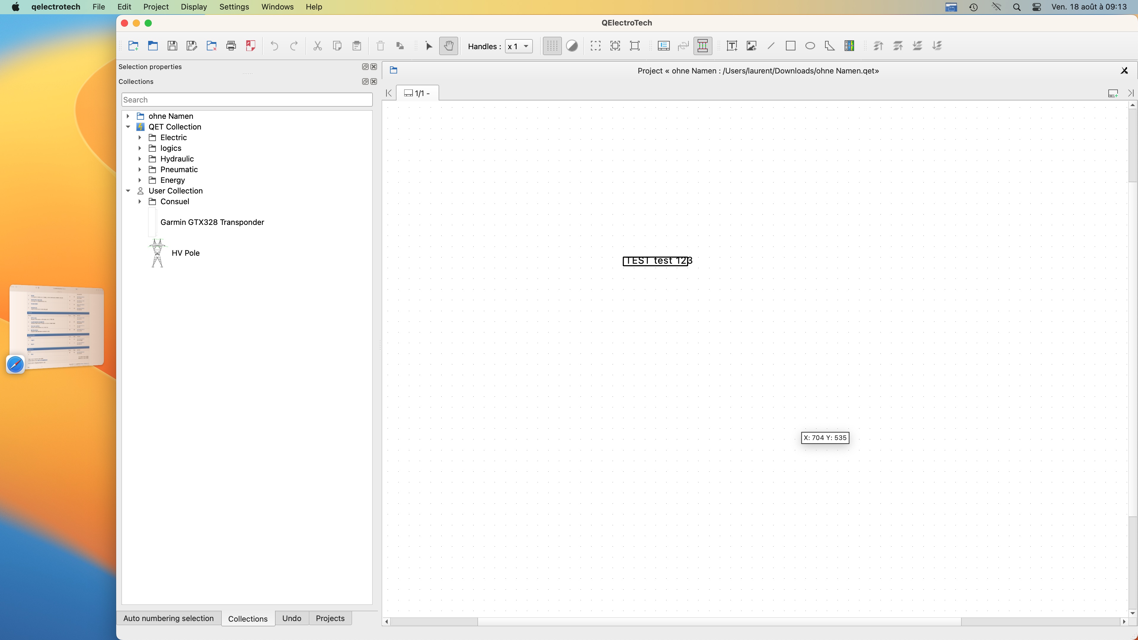

Re: MacOS Schaltplan sieht in Windows anders aus
Hmm, same font...but metric of the font size isn't the same...
On Linux Debian on 27 " UHD 4K monitor
</style></head><body style=" font-family:'Noto Sans'; font-size:9pt; font-weight:400; font-style:normal;">
macOS Ventura arm64 package on Mac mini M2 with 27 " UHD 4K monitor
https://download.qelectrotech.org/qet/forum_img_2/macos.jpeg
https://download.qelectrotech.org/qet/forum_img_2/Debian.png
Debian.png, 62.04 kb, 2579 x 1823
