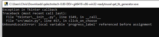

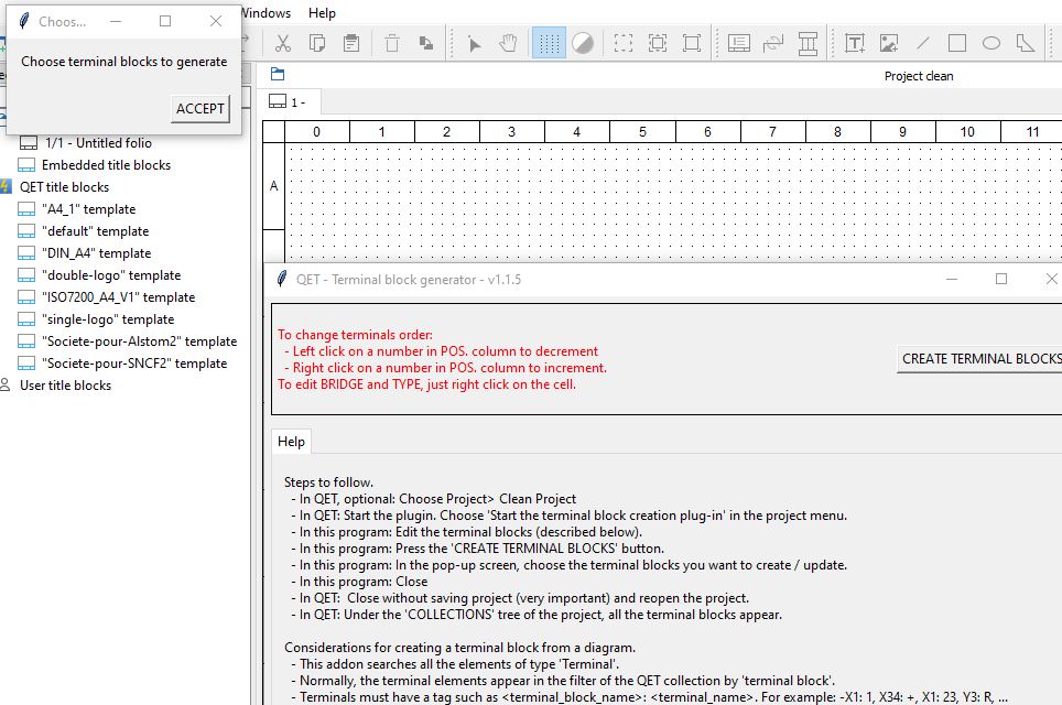

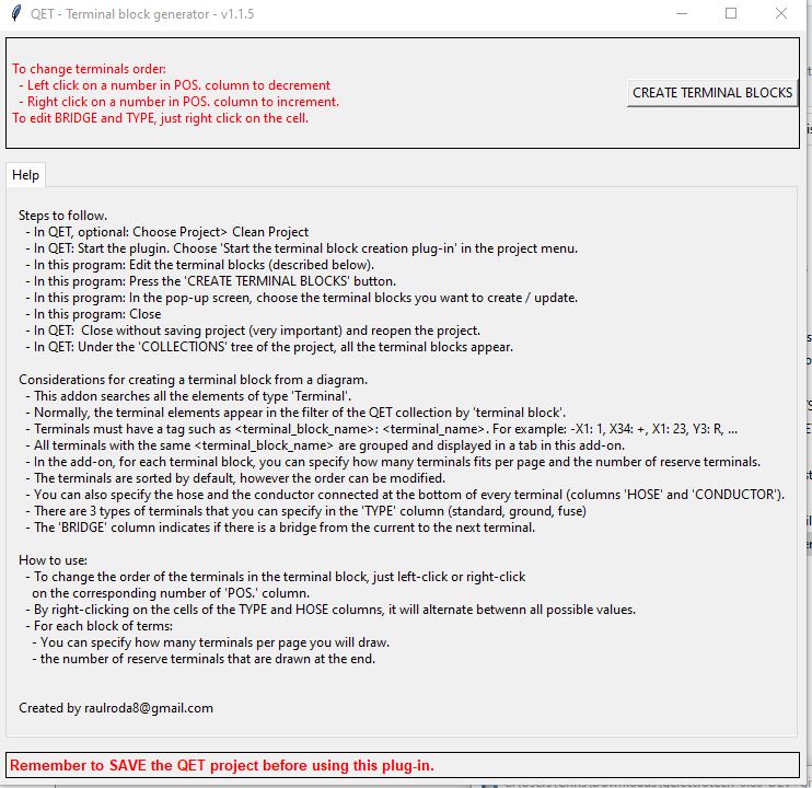

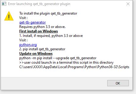

                     Thanks for the speedy reply, I have removed all instances of Visio, python and QET files. Downloaded the portable from the nightly as suggested, I still receive the same pop up within QET when i try and Project>Launch the Terminal Block Creation Plugin
If I then double click on qet_tb_generator.exe I am faced with a larger box with the option to "create terminal blocks" as per 2nd error attachment, within the dos box shows an error as per attachment 3rd error. after closing and restarting I now receive errors as per attachments 1 & 2, then when clicking on create terminal blocks it pop up a box "Choose terminal blocks to generate" Accept. When I accept  attachment 2 error still remains. Attachment 3 will also show my directory path.
I guess I must be missing a step somewhere but dont understand where?
1st error.JPG, 33.96 kb, 459 x 316

2nd error
2nd error.JPG, 126.74 kb, 742 x 720

3rd error
3rd error.JPG, 30.42 kb, 672 x 160

This attachment give a view of the choose terminal blocks to generate popup
Hopefully this will identify what i am missing?
4th error.JPG, 127.59 kb, 964 x 640
