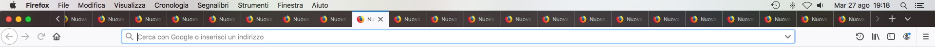

Firefox has arrows instead.
I attach screenshots of both browsers for reference.
(sorry but I had to split the message)

11 (edited by bgio 2019-08-27 19:47:05)
Re: Impossible to scroll page tabs (left-right) on Mac and how to compile
(It's very hard to use this forum)
Attachment icon Firefox tabs 2019-08-27 alle 19.18.51.jpg 59.27 kb, 198 downloads since 2019-08-27
