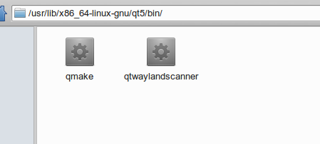

19 (edited by Calypso 2017-12-08 11:20:38)
Re: install the DXF converter 2017-Jul-18
Hello scorpio810,
what do you mean the file is there.
Best regards
Stebo
Hello Caplyso,
have you tried to compil it now?
Download source files :
svn checkout svn://svn.tuxfamily.org/svnroot/qet/qet/branches/DXFtoQET3_DB DXFtoQET3_DB
Go to directory :
cd DXFtoQET3_DB/
Compilation
/usr/lib/x86_64-linux-gnu/qt5/bin/qmake
make -j$(nproc)
Make it executable
chmod +x ./DXFtoQET
Test if run
./DXFtoQET
Now move or copy to QET user folder
mv ./DXFtoQET ~/.qet/
Now, the DXF converter can be started from the QET editor menu.
