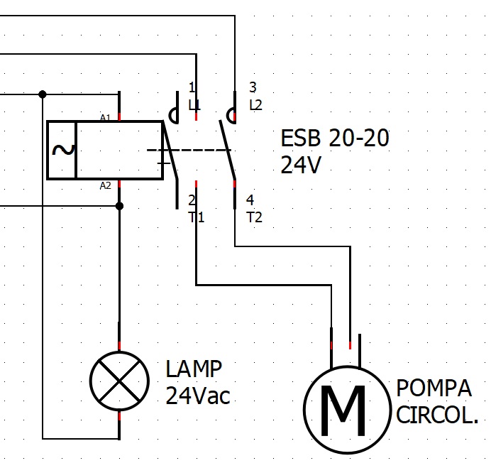

Still some graphic issues while moving schematics from fullHD monitor to 4K monitor: elements with multiple contacts do not resize properly and lose their own conductors.
With latest 0.7-dev or with 0.60-rc2 packages?
Because of my Ryzen segfault in heavy workload/compilations 0.60-rc2 windows packages is builded with Qt 5.8, now I use a workaround for fix it and wait AMD answer for RMA it.
0.7-dev packages is builded by latest Qt 5.9.1 libs.
With latest 0.7-dev.
