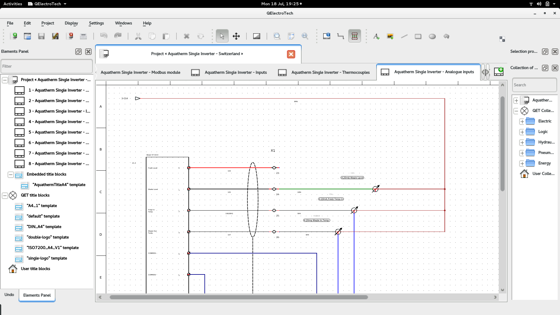

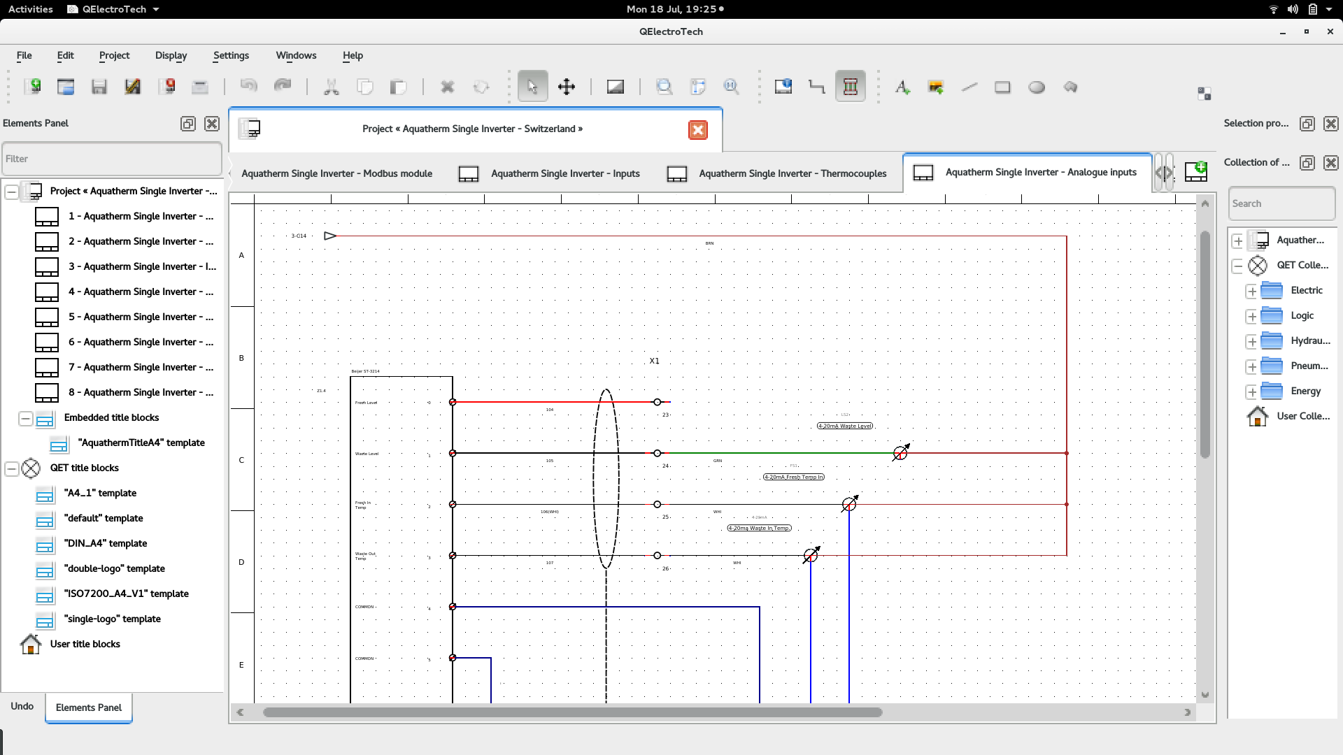

I have a HP Spectre and run a resolution of 1920 x 1080, however QElectrotech doesn't display according to the resolution.  Is it a QT error or possible to change via a conf file.
I have the latest version from the Fedora COPR, and am running Fedora 23.  I've attached a screenshot.
Thanks,
Jon

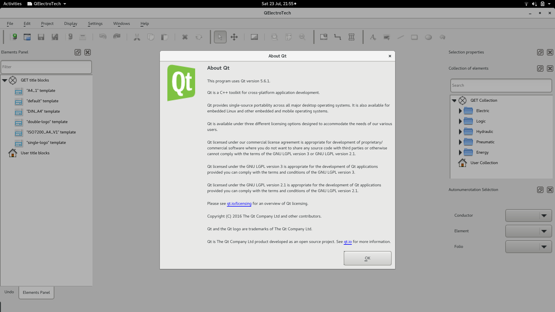

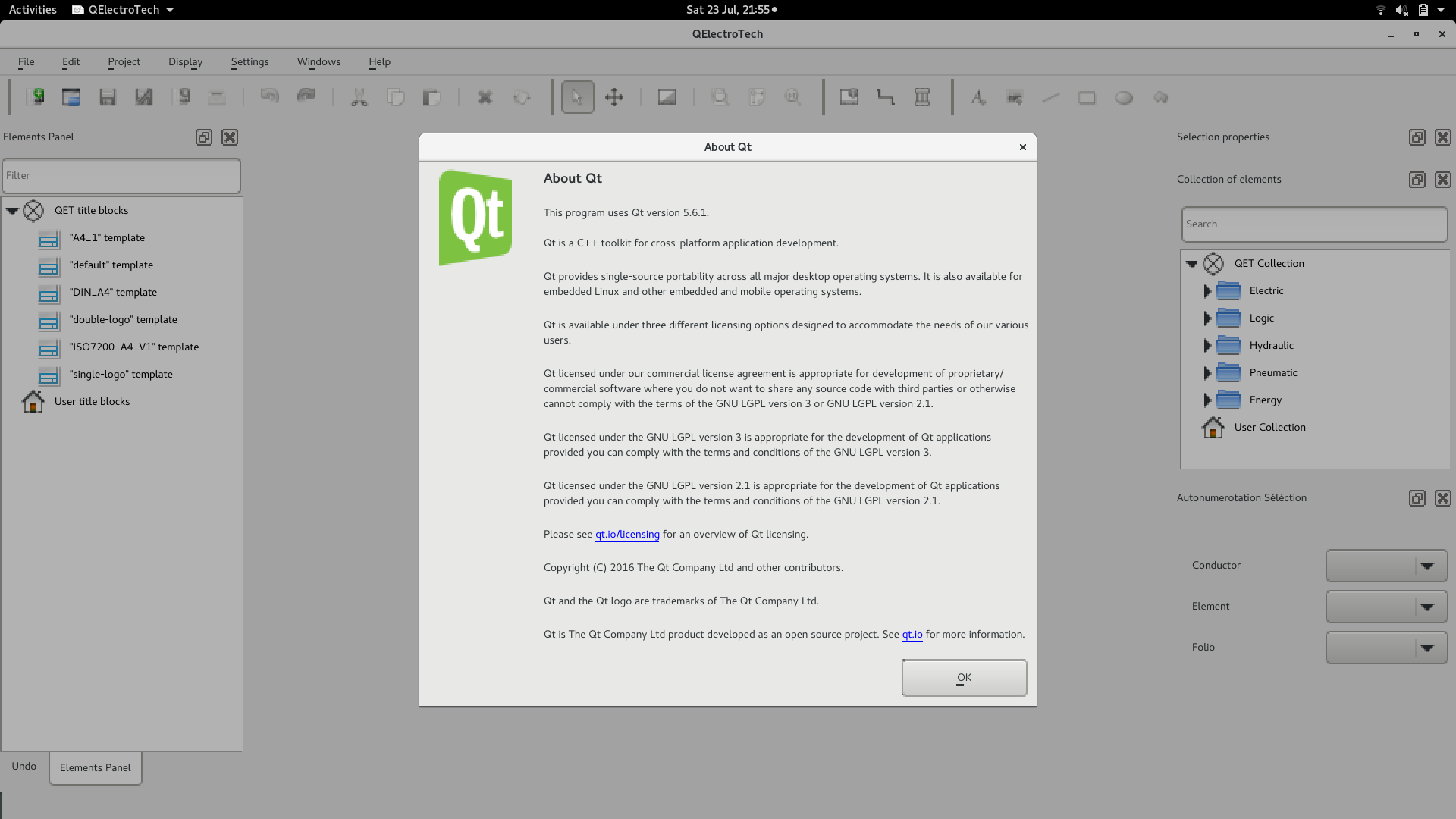

Laurent,
You are indeed correct, I am running 1920 x 1080 not HiDPI.
I have Qt 5.6.1 running, and have upgraded to FC24 but it still displays incorrectly.
Jon

Re: HiDPI mode
Jon,
I think you must reporting to mainstream Remi Collet this bug.
It 's very strange, I've never heard about this problem recently on Ubuntu or Debian with latest Gnome shell !

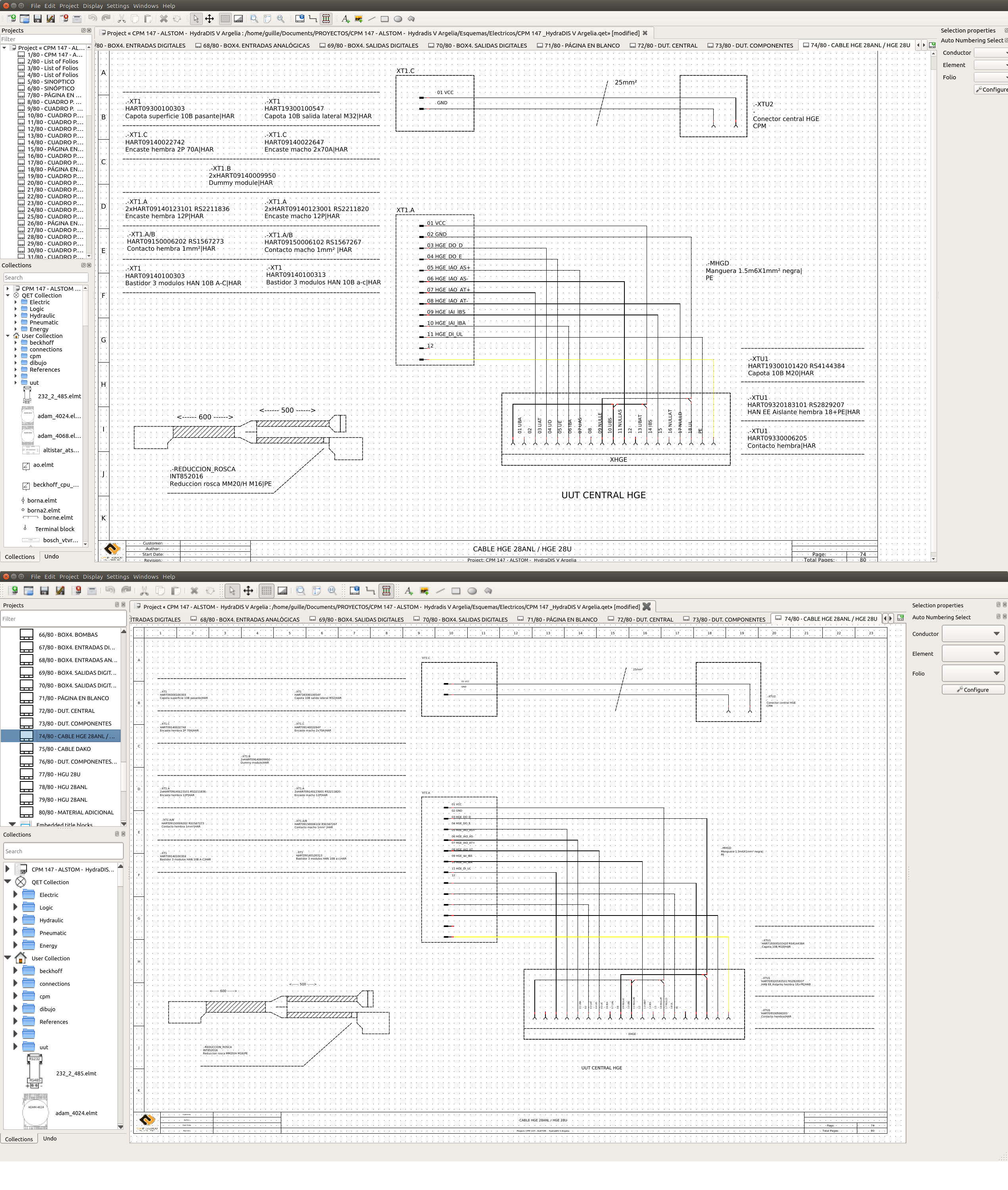

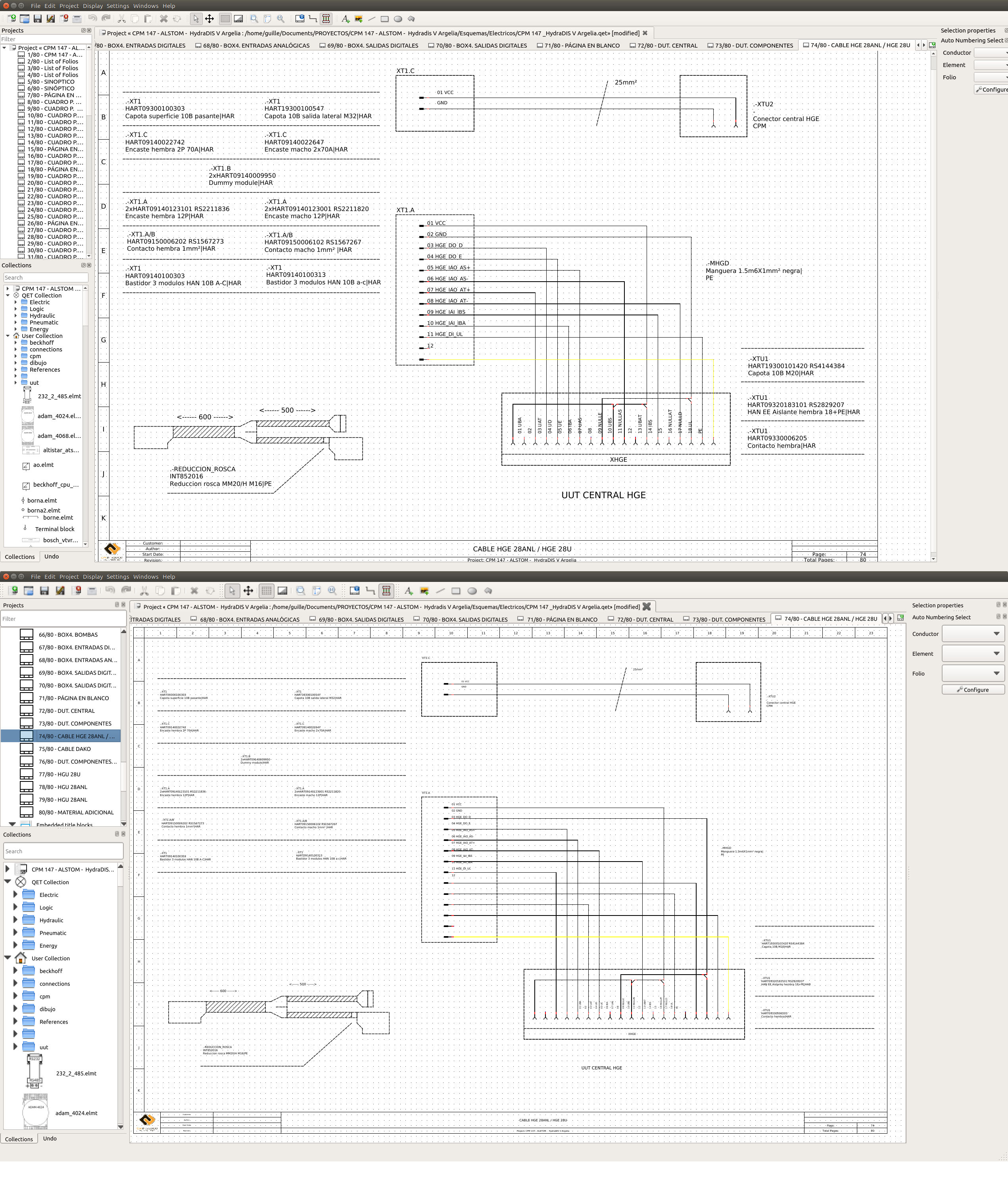

Hello Scorpio,
I am using Unity and QT 5.7.1 under Ubuntu 17.04
The main problem is that text are shown smaller under 4K in relation with other elements of the schematic.
Attached you can see the same schematic opened with and without the flag [size=1][font=Verdana, Helvetica, Arial, sans-serif]QT_AUTO_SCREEN_SCALE_FACTOR=0[/font]
Re: HiDPI mode
You could try latest svn ubuntu packages?
https://launchpad.net/~scorpio/+archive/ubuntu/ppa
0.60.r4962
I reverted it after. nomicons/smiley-green

Re: HiDPI mode
I've upgraded right now and version 0.60.r4962 works properly.
Thanks
