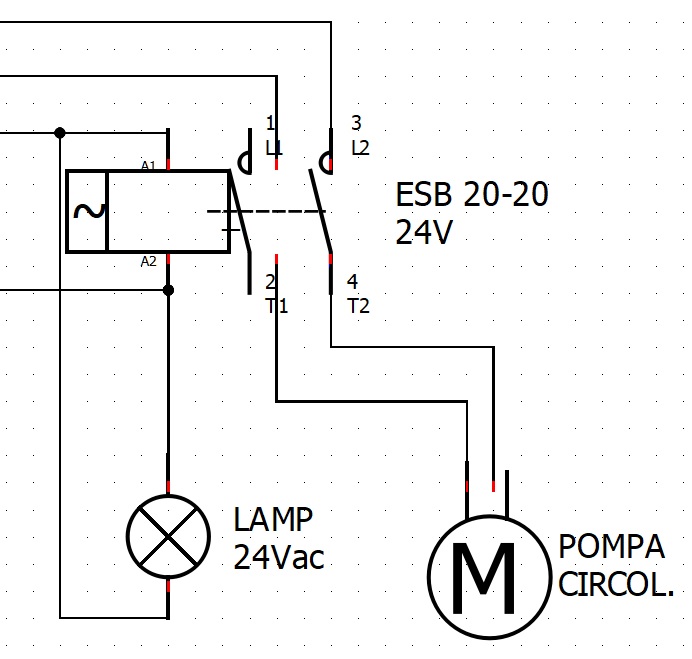

Still some graphic issues while moving schematics from fullHD monitor to 4K monitor: elements with multiple contacts do not resize properly and lose their own conductors.

Same issue.
screenshot.jpg, 74.91 kb, 692 x 659
