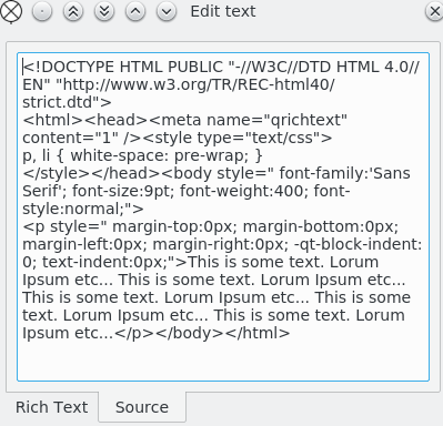

Hm, i still have not found a way to make text autowrapping in qet, but I am no HTML wiz.
I can make a one cell table with long text that wrap when i open it in web browser, but it do not wrap in QET, it just expands... even out of folio...
How do i tell it a max width?
@ Morganol:
I played with some css attributes in the "source" tab of the widget "Edit text" but it seems that Qt overwrite some values or do not accept all css attributes:
I tried the following:
<div style="max-width:20px;">
<p>your text here</p>
</div>
--> do nothing! Qt delete the <div> tag.
