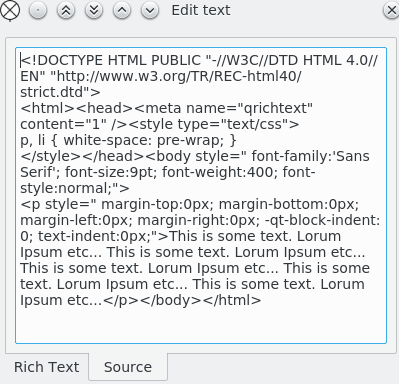

Now I am writing descriptions, bunches of text, on Qet drawings.
It there a way to make the text line wrap automatically?
I want the textblock to have a certain width, and wrap the lines automatically.
Re: Text automatic line wrap ?
Maybe i can edit the text in source mode.
Maybe use a "table" of one cell?
Ore some other trick...
I am not used to HTML, but surely can read up on it if that is a solution.
But how is actual total width defined?
How big is a "px" or whatever measure is suitable
Screenshot_20161014_152153.png, 54.17 kb, 399 x 384
Hm, i still have not found a way to make text autowrapping in qet, but I am no HTML wiz.
I can make a one cell table with long text that wrap when i open it in web browser, but it do not wrap in QET, it just expands... even out of folio...
How do i tell it a max width?

@ Morganol:
I played with some css attributes in the "source" tab of the widget "Edit text" but it seems that Qt overwrite some values or do not accept all css attributes:
I tried the following:
<div style="max-width:20px;">
<p>your text here</p>
</div>
--> do nothing! Qt delete the <div> tag.
then I tried:
<ul style="max-width:20px;">
<li>your text here</li>
</ul>
--> do nothing! Qt delete the "max-width" attribute.

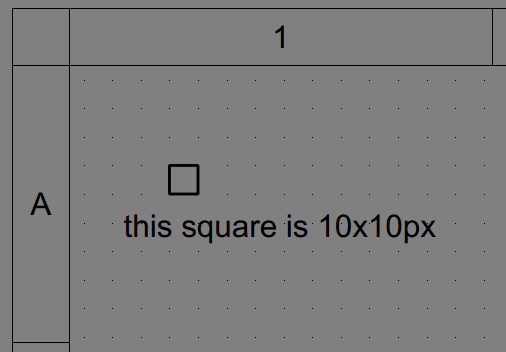

For your information:
the distance between 2 dots of the grid in the diagram editor is 10px.

Thank you Nuri for investigation and knowing the scale 1 grid dot = 5px

8 (edited by Nuri 2016-10-20 10:43:25)
missunderstanding, I mean it like this:
nuri-square_10x10px.png, 9.76 kb, 506 x 352
