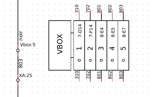

Hi, I finished a python program to make terminal block based on the previous bash script. I think it works well and fast. I've only tested it on linux, maybe some changes are needed to work in windows.
This version drwa a libe (bridge) between near terminals with same cable numbers.
If someone can test and improve it will be good for QElectroTech users !!
(sorry for my english)
http://i65.tinypic.com/11rxla8.jpg

Ok, it's work Important: folder need to exist before execute script. Wonderfuls elements !
Label of terminal don't respect minuscule letter : for example : label "Vbox " become "VBOX" (all in capital)
The script don't add missing terminals like reserve. See next post ...

About Xref: I have some problem with column. I think there is problem with calcul and round.
Exemple with XA:14
