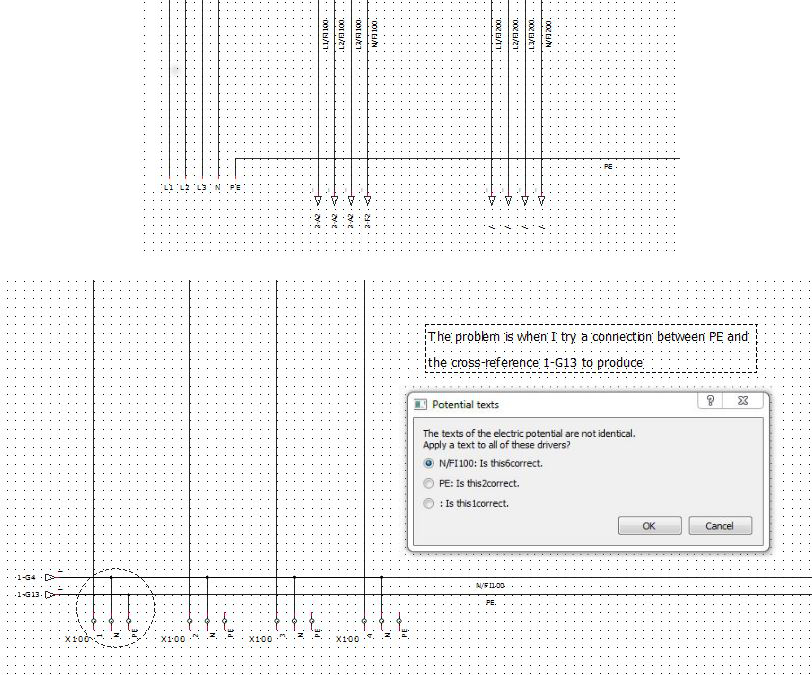

Hello
I have two pictures of the drawing looks like here with me. There is no connection between N / PE when I insert a new connection between cross-reference 1-G13 and the terminal X100 / PE appears the selection. Opt N / FI100 specify the potentials in PE N / FI100 be changed and if I will select them PE also changed the N potential in PE
Re: potenzials
Strange, but you are right.
Delete all connections  N and PE in all X100 and redraw also it run better after.

Hello
After several try with terminals I've found the problem has to do with what is selected when the component editor as basic type. Is simply selected as the base type will not make any mistakes. Is selected as the basic type terminal strip conductors names get mixed up. Is it important for a function, which is selected as a terminal base type
Sincerely yours
