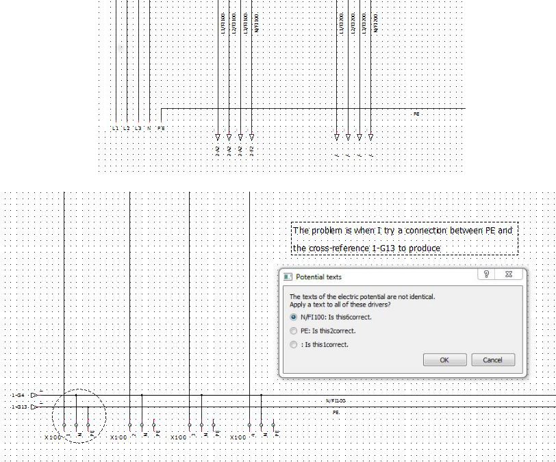

I've been working with some versions QTech but with all the problem with cross-references. If I call the current-carrying conductor with eg L1, L2, L3, and this is with fuses Connect everything OK
but if I label manager with N and PE, and this will connect with, for example, terminals shown me again and again, the PE or N several times exist no matter how I this confirms all previously designated Leiter renamed PE or vice versa as if a connection would be between the potentials.

I have two pictures of the drawing looks like here with me. There is no connection between N / PE when I insert a new connection between cross-reference 1-G13 and the terminal X100 / PE appears the selection. Opt N / FI100 specify the potentials in PE N / FI100 be changed and if I will select them PE also changed the N potential in PE

Strange, but you are right.
Delete all connections  N and PE in all X100 and redraw also it run better after.

I have the error found it was the terminal
but I do not know why. I have the terminal new created

After several try with terminals I've found the problem has to do with what is selected when the component editor as basic type. Is simply selected as the base type will not make any mistakes. Is selected as the basic type terminal strip conductors names get mixed up. Is it important for a function, which is selected as a terminal base type
