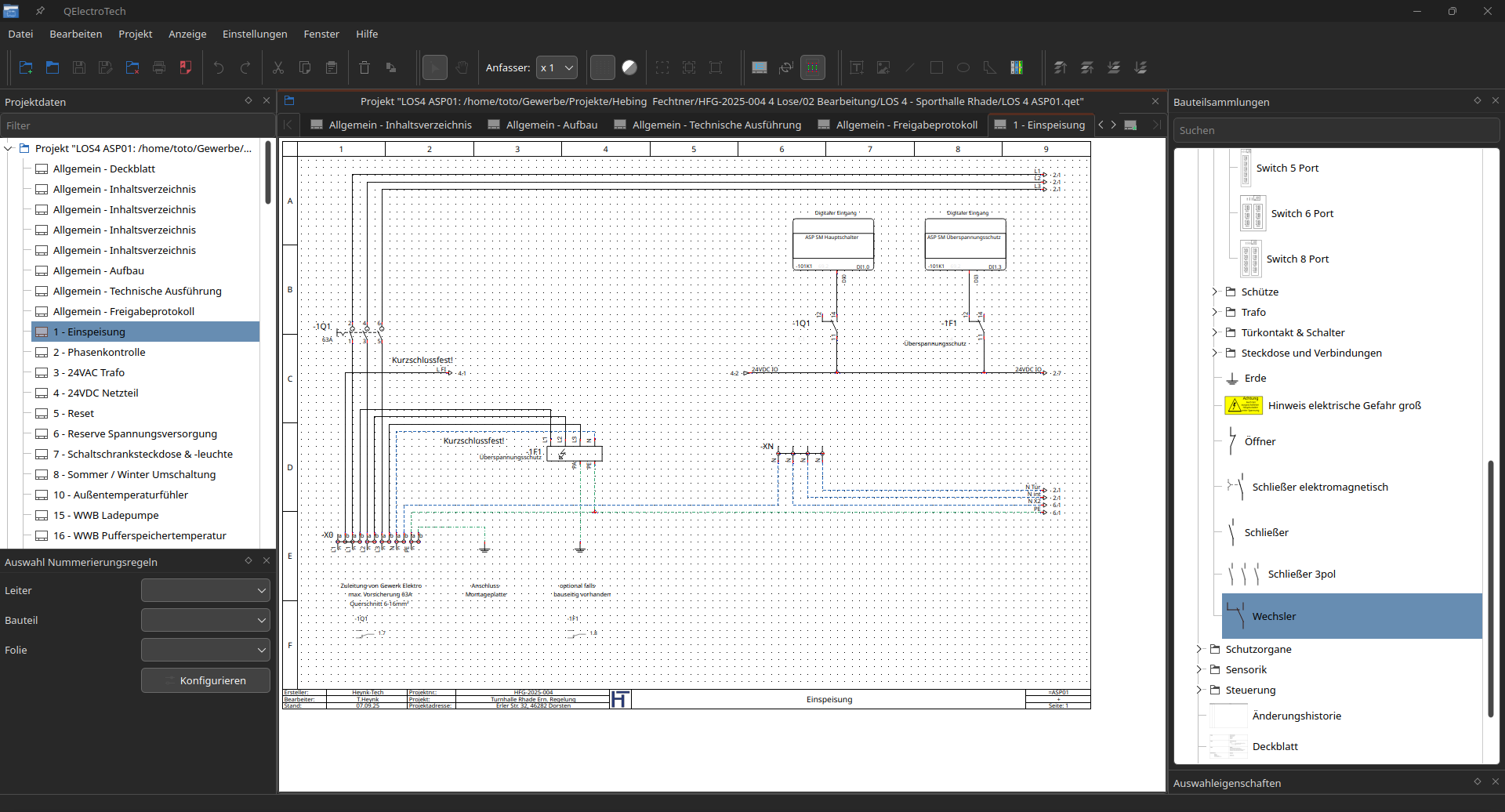

seit kurzer Zeit habe ich das Problem, dass Querverweise an Slave-Bauteilen sehr hellgrau sind. Erst wenn ich mit der Maus darüber gehe, werden diese wieder richtig dargestellt.
Beispielbilder sind angehangen.
Hat jemand eine Idee, was man machen kann, dass diese wieder richtig dargestellt werden?

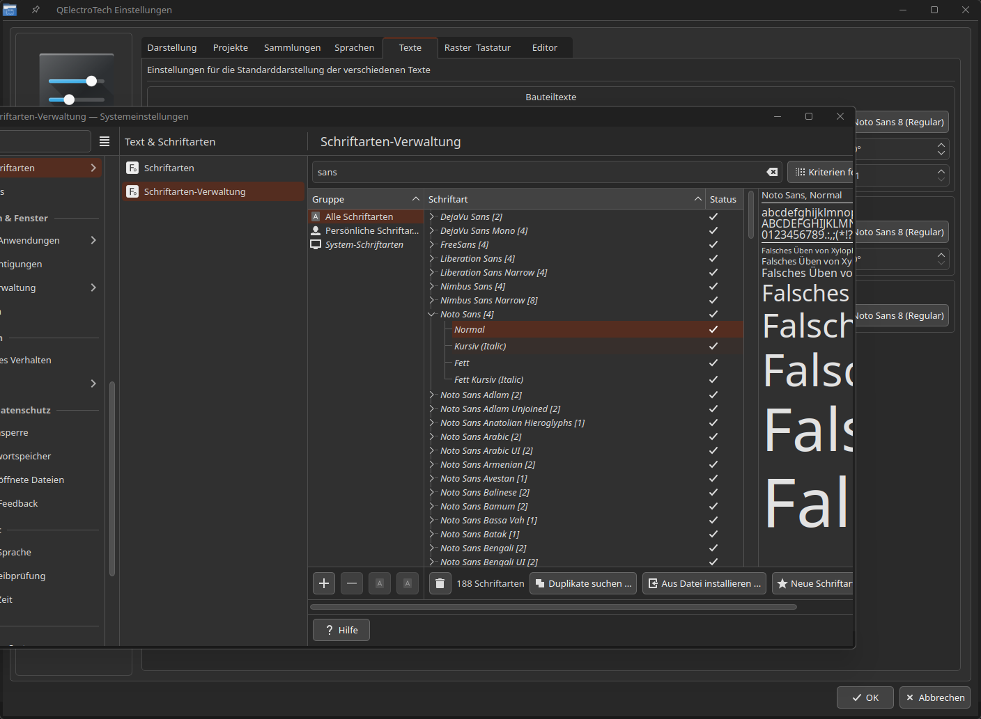

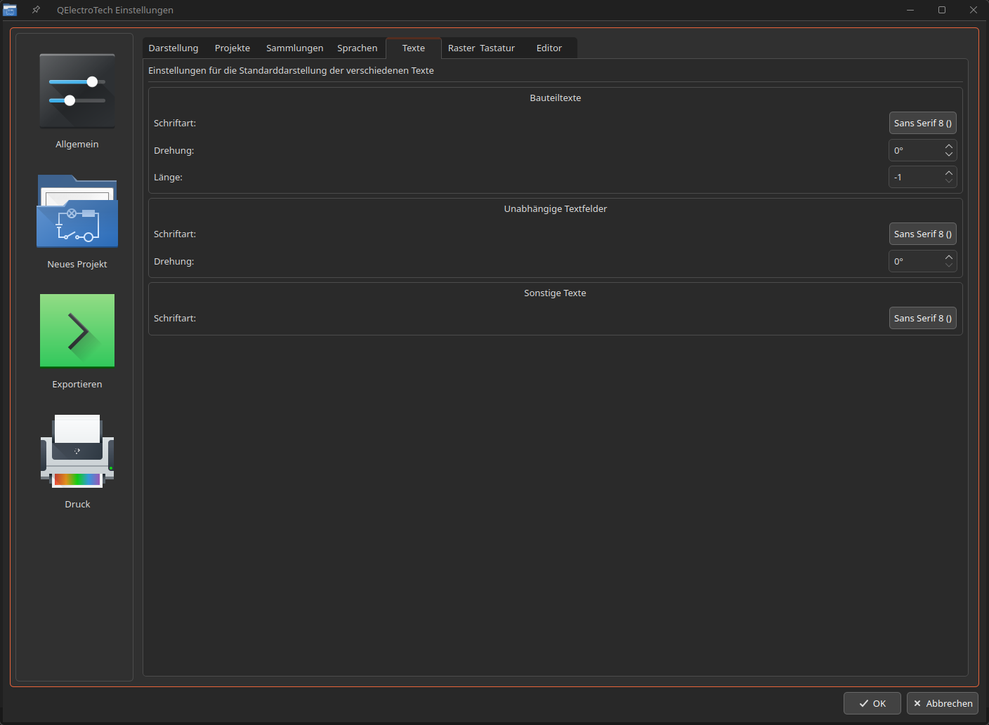

I have Sans Serif 8 everywhere in the program settings.
This works for the main elements. So how can it be due to the font, and how can I check/fix it?

I've changed to noto Sans but nothing changed.
I'm using Tuxedo OS.
Does it means the Problem is from Tuxedo OS?
It wasnt all the time with Tuxedo. Just about 1 Month.
I also changed all Sans Serif to Noto Sans with XMLCopyEditor.
Everything is like before.
All other Text is normal, just this not and they were also sans serif
On the Picture from the Page u can see, that everything else is fine. Also the Crossreferenc from the Master.
When i move my mouse over the Reference then its normal. All the time i have open up the Project. Then its also normal in the PDF. As soon as i reopen the Project it is so gray again.
I also took a component from the Qeletectrotech library. The font set there is Liberation Sans. Here, the cross-reference is light gray, which is the same behavior.
"Sans Serif" ist strenggenommen halt keine Schriftart...
