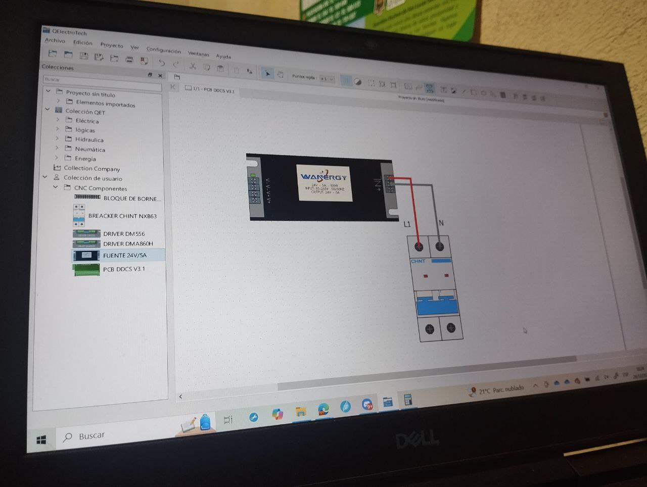

I appreciate the prompt response provided, I was able to install the qelectrotech plugin satisfactorily, now I have another couple of questions, I hope this doesn't sound overwhelming.
1.What is the correct way to create a new element from a DXF?
I am currently importing my DXF to the new elements editor in qelectrotech, to be able to add the necessary connections, but I see that the DXFTOQET tool is suggested in the forum. Does this program perform the same procedure or does it perform any additional processes?
2.What scale does Qelectrotech work on?
Currently, from the element editor I exported a DXF with measurements of 100mm 27mm (100 X 49.92mm).

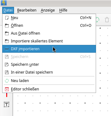

Did you notice the menu-entry just below "Import scaled element"? (see attachment!)
AND: Use the conversion-tool dxf2elmt! The other tool is VERY outdated!

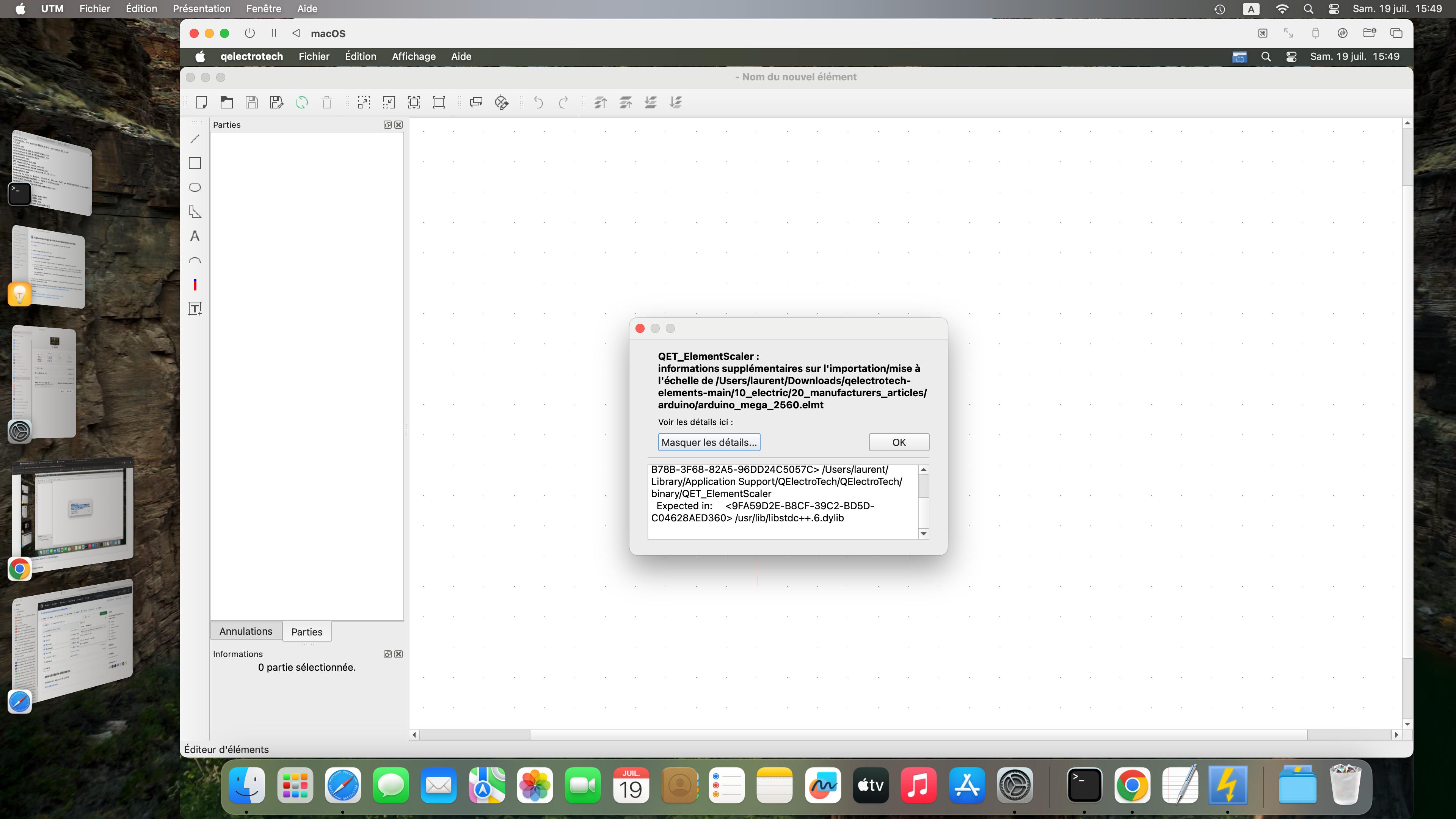

I build new QET_ElementScaler 0.5.4 macOS aarch64 binary, because binary provided by plc-user didn't work!
Hallo plc-user,
I tried your macOS aarch64 binary on new UTM virtual machine:
https://github.com/plc-user/QET_Element … /tag/0.5.4
The binaries for macos are to be seen as a “trial version” to see if the toolchain from the Docker image works, I don't have the possibility to test the executables.
FYI, QET_ElementScaler was saw as a document, so chmod +x QET_ElementScaler but binary crashed with:
dyld[1287]: Symbol not found: __ZNKSt7__cxx1112basic_stringIcSt11char_traitsIcESaIcEE4findEPKcm
Referenced from: <D63C1A82-B78B-3F68-82A5-96DD24C5057C> /Users/laurent/Library/Application Support/QElectroTech/QElectroTech/binary/QET_ElementScaler
Expected in: <9FA59D2E-B8CF-39C2-BD5D-C04628AED360> /usr/lib/libstdc++.6.dylibBest regards,
