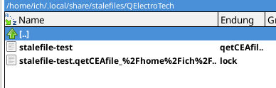

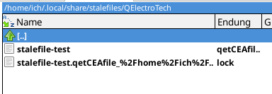

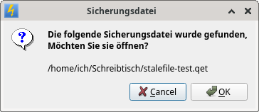

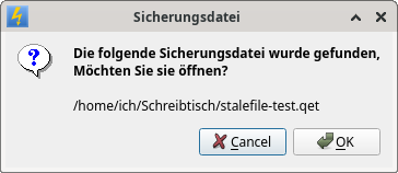

Re: Set Config- and Data-Directory to system-specific paths
Salut Laurent !
With no code-change in stale-file handling.
In the attachment: A short story of stalefiles in pictures. nomicons/wink

Users just want to know the PATH of stalesfiles:
https://qelectrotech.org/bugtracker/view.php?id=209
The path to stalefiles-directory seems to be:
QStandardPaths::writableLocation(QStandardPaths::GenericDataLocation)

On my Debian - machines the stalefiles-directory for QET is this:
/home/ich/.local/share/stalefiles/QElectroTech/
