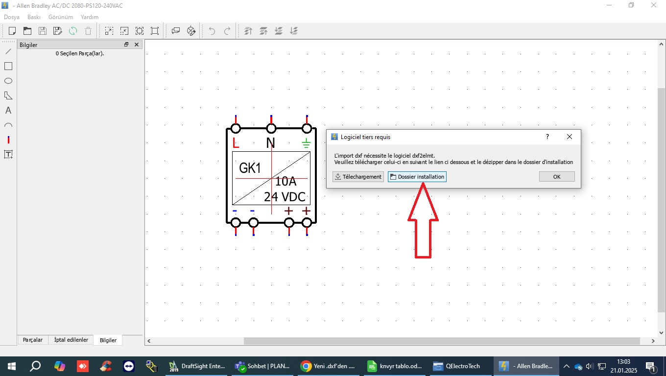

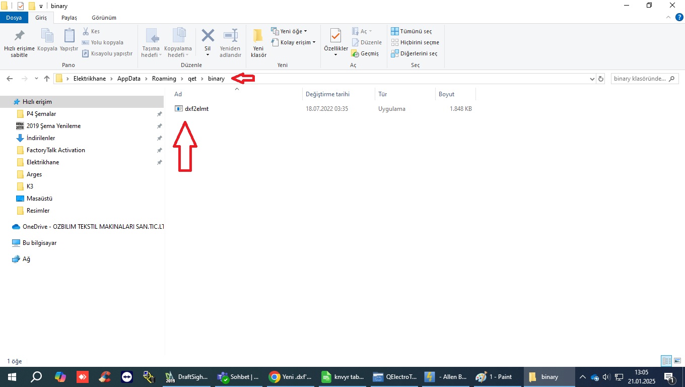

good day. Even though I click on the "installation folder" to convert the dxf file, it does not open. So I created my own folder and added "binary/dxf2elmt" into it. Even though I enter the program and click on the "installation file" again with the mouse, it does not open. Can anyone help?
''Sorry if there was any mistake in the translation, I did it with google translate.''

lanet wrote:
good day. Even though I click on the "installation folder" to convert the dxf file, it does not open. So I created my own folder and added "binary/dxf2elmt" into it. Even though I enter the program and click on the "installation file" again with the mouse, it does not open. Can anyone help?'
In the sources of QET one can find, that the "installation folder" is this one on windows:
(QDir::homePath() + QStringLiteral("/Application Data/qet/binary"))
should resolve to:
c:/users/$YourUserName/Application Data/qet/binary
Maybe a permission-problem?

@lanet: in principe the right path is  C:\users\your_name\AppData\Roaming\qet\binary\  under Windows.
BTW, if you use last 0.100-dev and my new packages of dxf2elmt of vadoola fork, you can saw a popup error if conversion DXF fail.

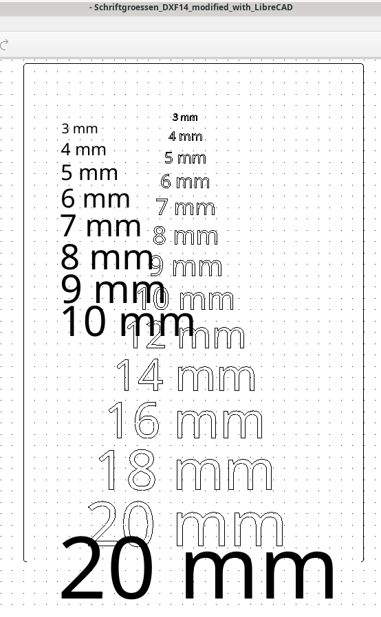

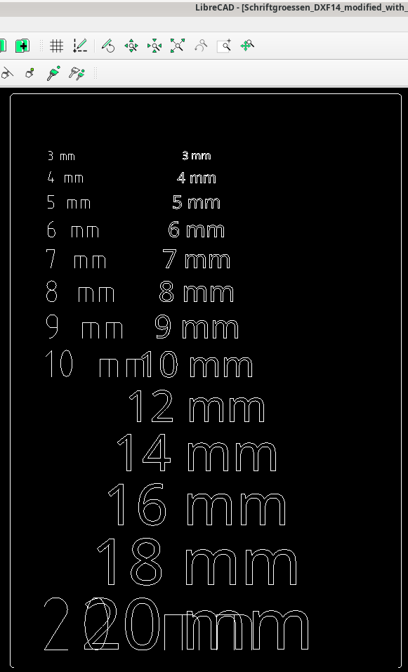

175 (edited by plc-user 2025-01-28 18:07:59)
Re: New .dxf to .elmt Conversion Program
Back to the topic:  nomicons/smile
Hello Vadoola,
I'm not quite happy with the font sizes yet.
That's why I used Inkscape to create a drawing with different font sizes. When I realized that the fonts were exported as polygons into DXF, I used LibreCAD to add some MText in different sizes.
I then converted the DXF into an element and realized that the font sizes did not fit.
If we focus on the 20 mm font:
In LibreCAD (black background) it is good to see that both texts are the same size - I expect the same for the element.
In the element (white background), the polygon 20 mm are 40px high, but the 20 mm text has a font size of 57.
So there is still a factor of about 1.4 somewhere in there that doesn't belong.
I noticed something similar with the imperial DXF from your American compatriot.
Packed all files into attached zip.

Bildschirmfoto_2025-01-28_Fonts_in_converted_Element.png, 35.1 kb, 554 x 898
Bildschirmfoto_2025-01-28_Fonts_in_converted_Element.png 35.1 kb, 168 downloads since 2025-01-28
Bildschirmfoto_2025-01-28_Fonts_in_LibreCAD.png, 23.44 kb, 581 x 957
