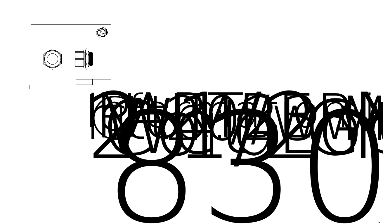

Howdy all, hope this is the correct place for bugs on DXF conversion, am playing around with doing an enclosure layout, so I grabbed a coordgrip dxf I could use off Mcmaster carr and the text is garbled to heck, may be useful for the "fun" text layout issues
Can grib dxf here since I can't upload it https://www.mcmaster.com/8302K738/
As a gift, a quick scale factor conversion sheet I made, after importing to ELMT if you know some dimension in real world units you can punch in coords of that in PX units and it will calculate scale factor based on 2px=1MM, its set in inches 'cause I'm 'Murican, but easy enough to knock the 25.4mm/inch out if needed
found best way to use is import -> save as element, measure, figure scale factor; delete contents of element, then do import and resize the element onto itself with calculated scale factor

I don't know what you are complaining about: the drawing is perfectly converted and the scale of 1mm = 2px is also correct!
And vadoola's statement is also correct: scaling of texts and their positioning still needs to be worked on.
What texts do you want to use for the front view of the element? You know the name, the part-number and the manufacturer...

I saw these fonts size was so biggest, like size= 1298 px ....
<description>
        <dynamic_text Halignment="AlignHCenter" text_width="-1" font="Arial Narrow,779,-1,0,0,0,0,0,0,0" y="210.57" frame="false" z="0" keep_visual_rotation="true" text_from="UserText" Valignment="AlignVCenter" x="187.3" rotation="0" uuid="{efa63688-1d59-4f48-b7c6-e61cac5ce680}">
            <text>2 1/2 NPT</text>
        </dynamic_text>
        <dynamic_text Halignment="AlignHCenter" text_width="-1" font="Arial Narrow,519,-1,0,0,0,0,0,0,0" y="325.1" frame="false" z="0" keep_visual_rotation="true" text_from="UserText" Valignment="AlignVCenter" x="157.78" rotation="0" uuid="{be6ff0b9-bd03-40df-9d2d-182c19e78a07}">
            <text>© 2023 McMaster-Carr Supply Company</text>
        </dynamic_text>
        <dynamic_text Halignment="AlignHCenter" text_width="-1" font="Arial Narrow,649,-1,0,0,0,0,0,0,0" y="332.53" frame="false" z="0" keep_visual_rotation="true" text_from="UserText" Valignment="AlignVCenter" x="353.73" rotation="0" uuid="{cf71a1f6-e8f6-468e-9a03-fc9026ffb867}">
            <text>Cord Grip</text>
        </dynamic_text>
        <dynamic_text Halignment="AlignHCenter" text_width="-1" font="Arial Narrow,649,-1,0,0,0,0,0,0,0" y="316.3" frame="false" z="0" keep_visual_rotation="true" text_from="UserText" Valignment="AlignVCenter" x="354.07" rotation="0" uuid="{3042b1a4-c128-4152-9e52-7059ad56692c}">
            <text>Wet-Location</text>
        </dynamic_text>
        <dynamic_text Halignment="AlignHCenter" text_width="-1" font="Arial Narrow,1298,-1,0,0,0,0,0,0,0" y="286.92" frame="false" z="0" keep_visual_rotation="true" text_from="UserText" Valignment="AlignVCenter" x="370.46" rotation="0" uuid="{bb0c5380-9eb0-4539-a6ba-e6747f8200e8}">
            <text>8302K738</text>
        </dynamic_text>
        <dynamic_text Halignment="AlignHCenter" text_width="-1" font="Arial Narrow,390,-1,0,0,0,0,0,0,0" y="339.87" frame="false" z="0" keep_visual_rotation="true" text_from="UserText" Valignment="AlignVCenter" x="159.08" rotation="0" uuid="{80473fb0-b6c7-44f1-9ad5-ef7252fb981a}">
            <text>Information in this drawing is provided for reference only.</text>
        </dynamic_text>
        <dynamic_text Halignment="AlignHCenter" text_width="-1" font="Arial Narrow,519,-1,0,0,0,0,0,0,0" y="288.12" frame="false" z="0" keep_visual_rotation="true" text_from="UserText" Valignment="AlignVCenter" x="275.08" rotation="0" uuid="{c0f52eaf-f682-4c51-8acc-94f969a7314c}">
            <text>PART</text>
        </dynamic_text>
        <dynamic_text Halignment="AlignHCenter" text_width="-1" font="Arial Narrow,519,-1,0,0,0,0,0,0,0" y="297.72" frame="false" z="0" keep_visual_rotation="true" text_from="UserText" Valignment="AlignVCenter" x="276.03" rotation="0" uuid="{5de7a2d5-516d-4d82-ac48-a286a2614338}">
            <text>NUMBER</text>
        </dynamic_text>
        <dynamic_text Halignment="AlignHCenter" text_width="-1" font="Arial Narrow,519,-1,0,0,0,0,0,0,0" y="313.47" frame="false" z="0" keep_visual_rotation="true" text_from="UserText" Valignment="AlignVCenter" x="157.18" rotation="0" uuid="{4ce33b0a-4f95-43cf-bb60-4f832b127733}">
            <text>http://www.mcmaster.com</text>
https://download.qelectrotech.org/qet/forum_img_2/andre_dxf.png
If I divide the size of all the fonts by ~100, the appearance and positioning are quite good.
https://download.qelectrotech.org/qet/forum_img_2/andre_elmt-divide_text_font.png
https://download.qelectrotech.org/qet/forum_img_2/andre_elmt-divide_text_font2.png
Edit: for this DXF file the fonts was so big, but I tried other DXF files and fonts seem's good.
No complaints sir, I am happy and thankful for the work on the importer and your resizer. I only bring it up because the text issue was mentioned and I saw the issues on the USA based DXFs I tried which leads me to wonder if they have a 3rd party backend generating these and if so fixing may be worth it. (as it would affect a ton of these DXFs)
Also if it's prescaled, I wonder if prev document I converted from DWG->DXF->Element was messed up or if I did some dragging around 1st by mistake

Lots to respond to...
The QET Forums, either this thread or creating a new one, are probably the best place for this. I do use Github Issues (https://github.com/Vadoola/dxf2elmt/issues) for tracking problems or enhancements etc., but if you make a post here, there can be a bit more discussion about it and I can make an Issue on Github, you are more then welcome to make a Github Issue as well though.
Thanks for the spreadsheet, I can take a look at it. The scaling should be in there already, but only recently and includes all the units supported by DXF. The code can be seen here: https://github.com/Vadoola/dxf2elmt/blo … od.rs#L213. Perhaps you grabbed a slightly older version of the conversion utility, because I only checked in that code a few days ago.
Yeah there is still quite a bit of work to do on the text but I'm slowly chipping away at it.
There are multiple text types in DXF
    * ArcAlignedText
    * MText
    * RText
    * Text
Right now Text should be somewhat well supported, but there are issues. MText has some very early and crude support, and the other two have no support. Just looking at the screenshot you shared (without having looked at the DXF yet) I'm guessing these are regular "Text" objects.
andrew wrote:
@Scorpio810, I may have to look into file format, but I assume the DXF has font size and QET has font size, so can't we get a porportion based on doc size and then just hit the font sizes with that (rounded as needed)
A font size of 1298 certainly seems wrong, I'll have to do some testing on that file to see what's going on. The DXF actually stores font height in drawing units, so if the drawing defaults to inches, the text height will be stored in inches not font points. I convert between real world units and font points at the code Laurent linked above and round it to a whole number. The conversion is based on the definition of a PostScript font point where 1pt is defined as 1/72 of an inch, and in my testing so far this seems to work well.
It's certainly possible and hard to know. I'll take a closer look at the dxf and see what I can find, it might be a couple of days before I can get to it though.

The font sizes should be correct in the latest commit (c3a5b2a). Before I had the real world units to Pt logic, I just scaled the text by the same scaling factor as the rest of the drawing as a temporary measure. I forgot to remove that code, so it was scaling it twice, once when converting between real world units and font points, and then again by the same factor the rest of the drawing was.
The handful of drawings I was using were in mm, so the extra scaling was 2x, but the drawing you were using was in inches, so the extra scaling was 50.8x.
There are still some other issues, with the text in that drawing for example in dxf the X and Y coordinates are based off alignment, in QET, they are always left and top regardless of alignment. So I need to add logic to do font measurements and that sort of thing. for this reason some of the text in the dxf is slightly off where it should be. Fixing is one of he things I was already starting to work on, but is more complicated, and will take a bit longer.

Re: New .dxf to .elmt Conversion Program
Salut Laurent !
