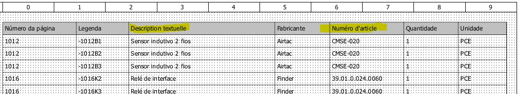

I'm new in the QElectrotech universe and I need help.
As you can see in the attach file, the field of index have a "mix" of languages, but the language selected is portuguese (Portugal).
I already try to find a way to fix the but without sucess.
A lot of other fields, including Menu's, also have this problem but for me that is not a issue since I use the QElectrotech in english during electrical diagram drawing, but when I want to export the diagram to PDF, as to be in portuguese.
Please, can you help me with this point?
Can someone explain me how can I solve this problem?
Thank you

Sorry, my bad about the not attach the file. I forgot to click on "Add file".
There is my problem now.
Best regards

I change the language as you recommend for Portuguese Brasilian as it solve most of the problem, but as you can see in the previous post image, I stil have some "untranslated" fields.

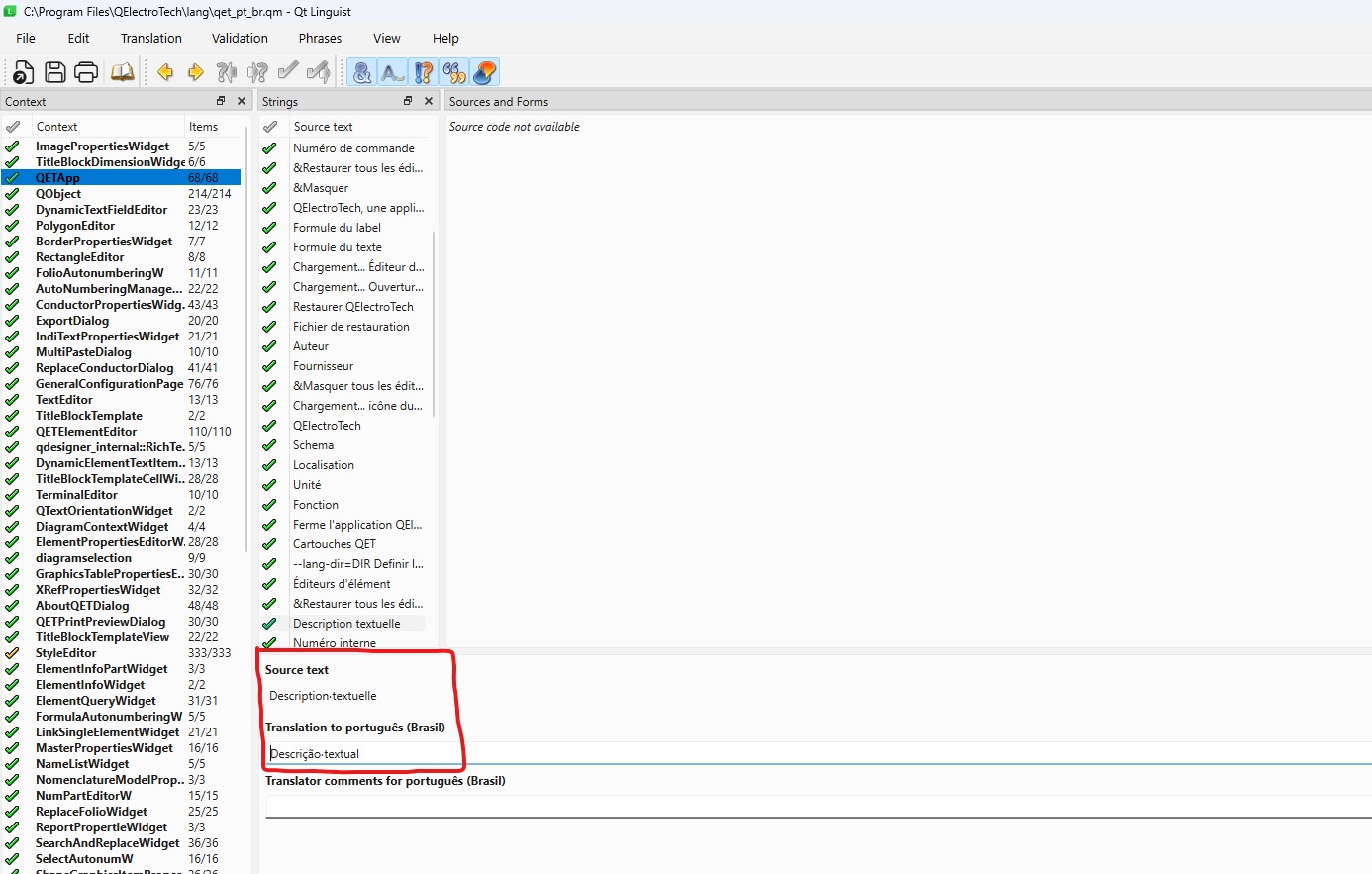

Also, as you can see in the image below, qet_pt_br.qm file, for example the "Description textuelle" have a translation for Portuguese Brasilian.
I don't know if exist other file that I need to open to see if the translation is made or not.
Please can you help me?
Thank you

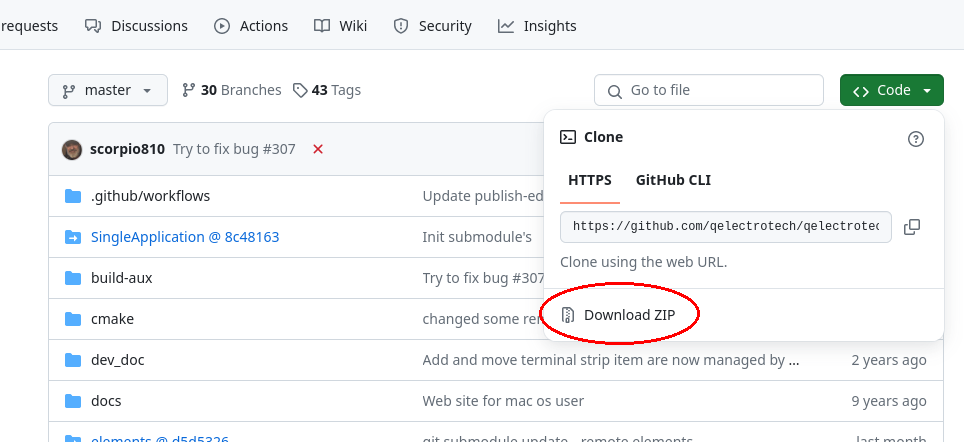

Hello samuelps.hr,
ts files was on github repository https://github.com/qelectrotech/qelectr … rce-mirror
Click on code button and download zip files  or clone git repository.
Here a little howto for bom https://qelectrotech.org/forum/viewtopi … 256#p16256

Hello samuelps.hr,
as Laurent already said:
First you need to download the whole sourcecode-package from github
and unpack to a local directory.
With Qt-Linguist you open one or more ts-files from that directoy-structure.
My suggestion: qet_pt, qet_pt_BR and qet_en
Then you can compare the translations.
When you look at the columns on the left and push the mouse-cursor over the symbols, you can see the "completion-status" for that translation. As you can see: There are many question-marks for Portuguese. In the screenshot you see that there is a translation for Portuguese, but the translator wasn't sure, if this translation is correct. When you say it's correct, set the status to "done", otherwise correct the phrase and then mark as done.
When finished you can "release" the language-files and publish them here (qet_pt.ts and qet_pt.qm) as ZIP or create a pull-request at github, if you have an account. But I guess Laurent would be happy to upload the files to github, if you post them here...!
