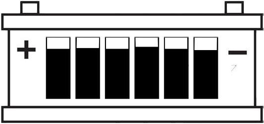

Just draw this image and want to us it as an element and save it in my lib.
I really thought that I could convert this to an element; but can't find it how to this.
On the terminals of the Accu/battery I want to create a Positive and Negative terminal to get it connected to the wire diagram.

Already tried but did get just an outline very ugly

your SVG cannot be converted to DXF because most of it is an integrated Bitmap!
There is only one rect as outline of the Battery and the six smaller white rects is one big path.
You can even see that when you open SVG in a Text-Editor (see attachment).
If you open your SVG in Inkscape and look at the "Ebenen und Objekte"-Tab (opened with via Menu) you'll see what's inside your SVG: Most of it is a Bitmap that cannot be converted by any DXF-converter.
Such "simple" Symbols can be drawn very quick and easy with QET's Element-Editor:
Only rects that can be duplicated by <Ctrl>-C <Ctrl>-V
Attachment icon Bildschirmfoto_Battery_in_Inkscape.png 19.88 kb, 118 downloads since 2023-12-04
Attachment icon Bildschirmfoto_Battery_in_Text-Editor.png 23.75 kb, 113 downloads since 2023-12-04

as far as I know photoshop can only handle pixel-graphic.
QET and Inkscape work with and produce Vector-Graphics.
If you have a pixel-graphic you have to work with "potrace" or the vectorising-features of inkscape to "trace" the graphic and thus create a vector graphic. In German Version of Inkscape: import a Bitmap to current file, click the image to mark it and then "Menü" -> "Pfad" -> "Bitmap nachzeichnen..." opens a tab where some parameters for tracing can be set.
When vectorised, converted to dxf, converted to QET-Element there is still much work to do, when you want to produce a fine-looking Element that only contains the necessary and visible parts. In the accu.elmt you attached earlier there are some polygons included that "blow up" the file-size but cannot be seen in the element because they are hidden behind the black rects! When I delete the invisible polygons, the file-size is reduced to less than half to 4.3kByte. When I adjust the English name of the element the file-size even reduces to 4.1kB...

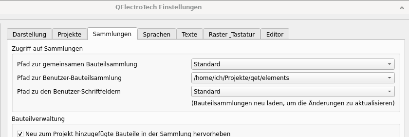

Hello rvamerongen,
you noticed, that you can have a User-Collection?
I created a User-Collection where I have a Sub-Folder for elements "in development" (see attachments).
Each with a separate "qet_directory"-file with a QET-name for the Sub-Folders...
This would be the place for your "templates".
Attachment icon Bildschirmfoto_Preferences_Collections.png 33.96 kb, 109 downloads since 2023-12-06
Attachment icon Bildschirmfoto_Sub-Folder_User-Collection.png 11.31 kb, 103 downloads since 2023-12-06

Re: Create an elmnt from a SVG file; or png file
Why not create a subdirectory for drafts there?
Some time ago I already suggested implementing a second user collection (https://qelectrotech.org/forum/viewtopic.php?id=2105), but the limited number of developers for QET unfortunately prevents this.
That was meant for another reason, but could be useful here, too.
Hallo plc-user,
you can change directory official or custom collection on the fly,
1] change PATH for custom collection.
https://download.qelectrotech.org/qet/forum_img_2/Bildschirmfoto_Preferences_Collections.png
2] on element collection tree field make a right click -> reload, and  voila. nomicons/wink
Regards,
laurent
