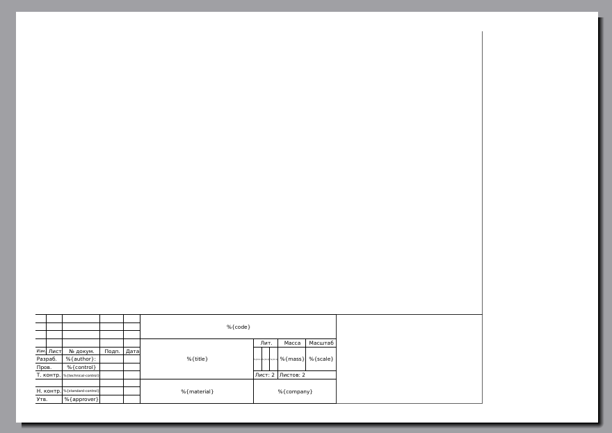

Re: Russian gost
This was really helpful, thank you! I am already half a way to be an electrical engineer nomicons/smile
I think, I have found it out, how to disable A-B-C… 1-2-3… titles, yet with them the borders of the canvas are also gone. Is there a way to draw them?
Also, the stamp is needed to be right-aligned. I have not found this option in QElectroTech, I am afraid. Is there it?
Then, there is another problem: the area right from the stamp (would be left, if align the stamp right) looks separated from the main canvas. It might be so, because according to European standards the stamp is 100% width of the canvas, might it not? According to GOST it is a working area as well.
And the last: this one is probably already answered, but I don't understand it, what is the amount of page's rows and columns to fit A4 page? And A3 page?
