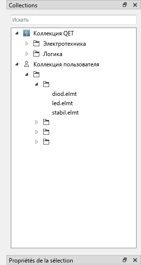

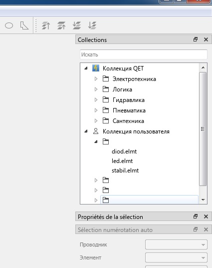

I don't use the QElectroTech program for a long time. First, I had a version of QT-0.70 RC 1-win64+svn5832-1 in it I created my collection of elements according to the Russian GOST. Then I updated this version to version QET-0.70-win64+git5967-1, the collection of elements was shown in the library normally. There were labels for each folder with elements, sketches of elements and so on. When I updated QElectroTech to version QT-0.80+87c957a06d79751d3, my collection of elements stopped displaying normally in the library. How it looks is shown in the screenshot of the program. When transferring an element to the schema field, it has a normal image such as it should be. I have Windows 7 Professional 6.1 SP1 64 bit. Maybe the latest version of Qelectrotech is incompatible with my Windows 7 or you need some updates and similar additions, for example, NET.Framework? Sincerely, Alexander.

Yes, the screenshot is at the bottom.
КПллекцОя.jpg, 21.73 kb, 287 x 539

This is a picture from a laptop. It has the same Windows, but I use it to store files that are valuable to me. There are fewer programs installed on the laptop.
Collection.jpg, 40.41 kb, 425 x 536

Hello. Sorry for the insistence, I wanted to find out about the issue of displaying "My Collection" in the QElectroTech program. Maybe I should go back to version 0.7? Sincerely, Alexander.

I returned version 0.7. I attach a screenshot. Probably version 0.8 and higher do not support Windows 7 SP1?
Collection My.jpg, 39.36 kb, 344 x 610
