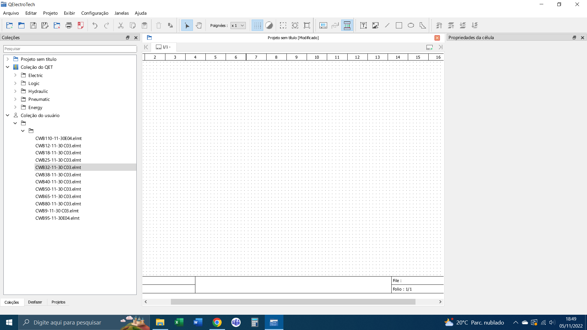

Hello,
I installed version 0.90-DEV+git7713-1, where I came across the following situation, in the collection of user elements, the name of the folders does not appear, where I already tried to change the path several times, I installed this version on the ntebook at home to be able to test and validate for other works, where I have been using version 0.7.
I would like help, because as I said, I've already made some attempts...
I'm waiting....
thankful.

I've made several attempts, but without success, until I create a new folder in the QET itself, it doesn't appear with mone, and the element itself doesn't appear in your design either.
but settings have a field where we define that directory or folder we are going to extract the elements or subfolders, I already configured it, but it doesn't work either.
D:\Users\Application Data\qet\elements
this being the path you are already selecting.

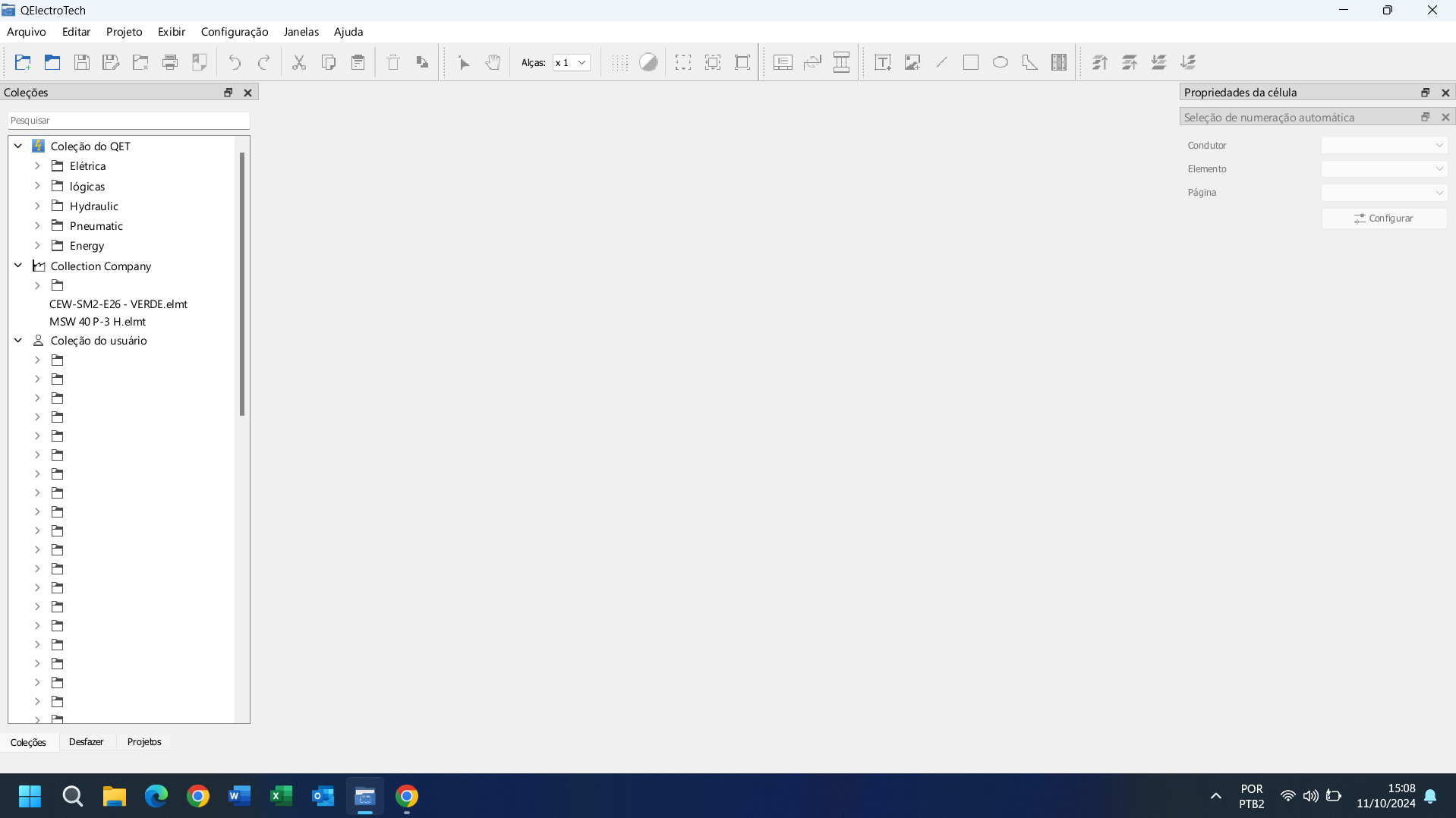

hello
I am changing computers, and the problem with the name of the user's collection folder happened again, and now this time it is installed in the right folder, so I need help to resolve this issue.
I already directed the path to the folder in the settings to try to adjust this, but without any gain, here are some photos and information to make this situation clearer.
this is the path to the collection files: C:\Users\User\Application Data\qet\elements

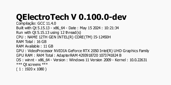

Captura de tela 2024-10-11 150901.png, 165.57 kb, 1918 x 1078

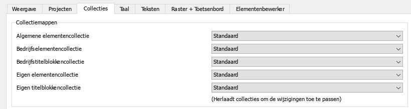

Is it possible to create a third option for configuring the collection elements? Currently, there's a choice between Standard and a folder. The third option: don't load the QET collection. Thanks in advance.

Simply enter an empty directory in the settings for the QET collection,
then no collection will be loaded

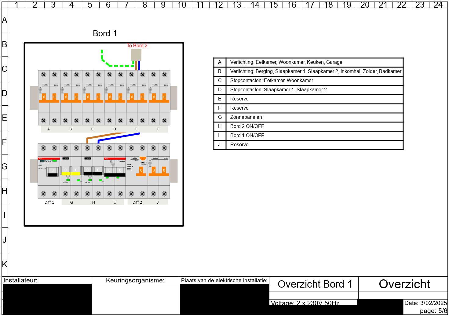

@scorpio810: My Os is windows. I've now installed the latest version 0.100 and selected only "Electrical Engineering." This is sufficient for me.
An empty directory in the settings using "achim" is also a solution. I've tried that too.

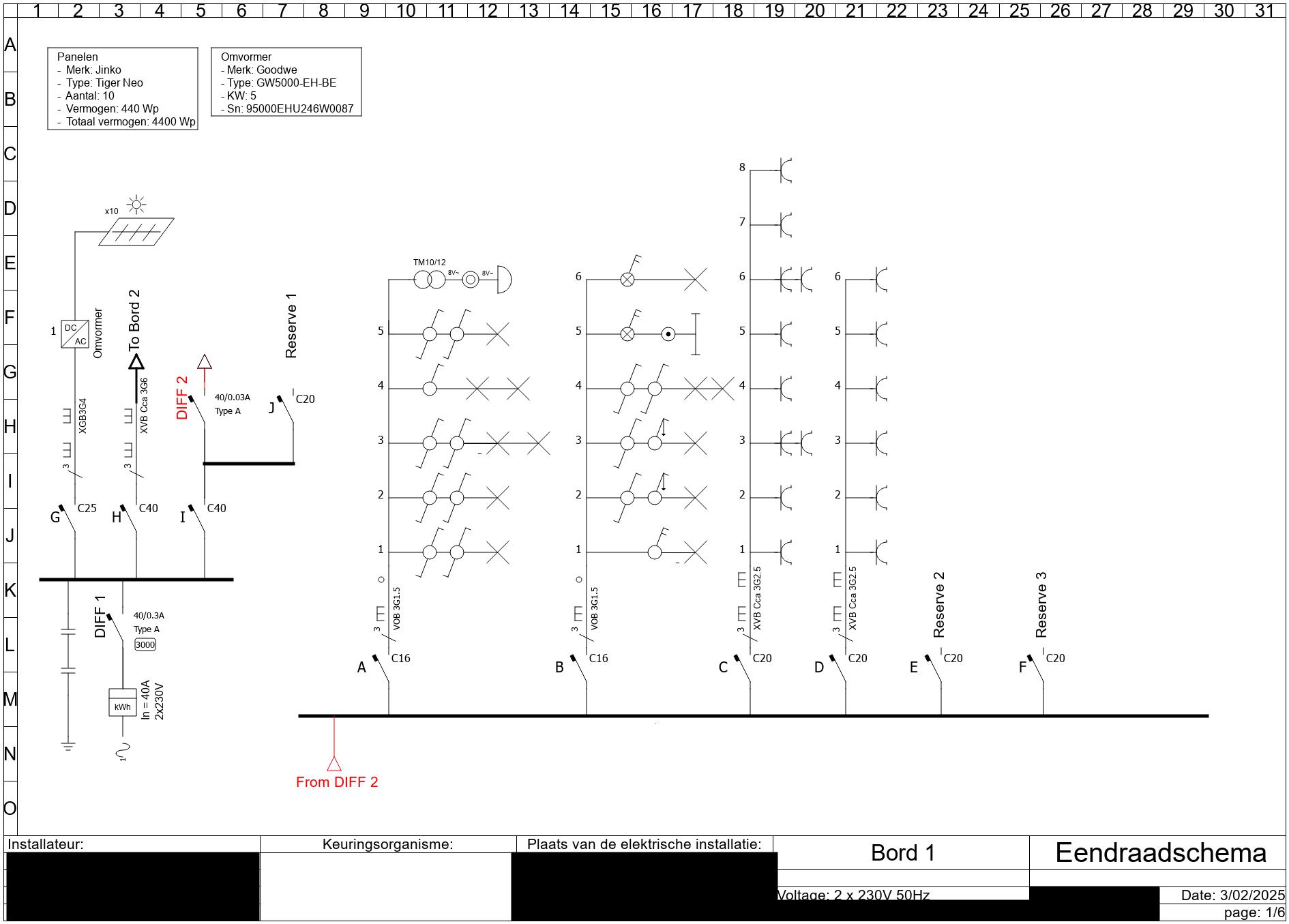

I use Q Electrotech to create the drawings for my electrical home installation according to the AREI (General Regulations for Electrical Installations) here in Flanders. See attachments.
Thanks in advance for the explanation.
Rony
