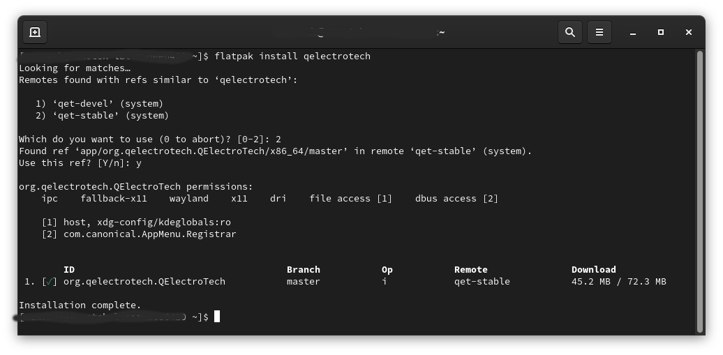

I have tried the Appimages, but prefer to have the application installed.
Is it possible to install 0.8 stable from flatpak?
In the screenshot you can see I selected the stable release, but the 0.9-dev is installed.

my repo is only for devel version.
You could try this :
flatpak install --user https://dl.flathub.org/build-repo/45176/org.qelectrotech.QElectroTech.flatpakref
https://github.com/flathub/flathub/pull … -831565755

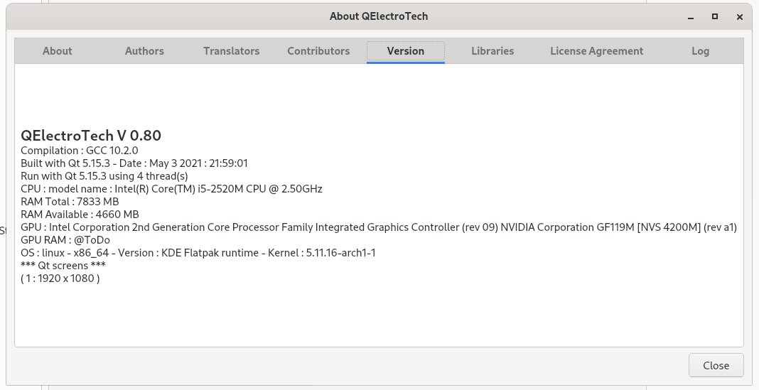

Thanks scorpio810
It installed 0.8.
