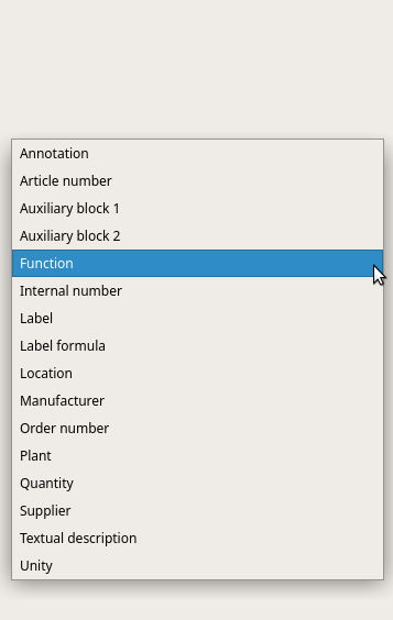

Re: Probleme beim umstig von 0.70 auf 0.8
Hallo Stebo,
tension/protocol variable was removed for element information widget, is only for conductors now.
