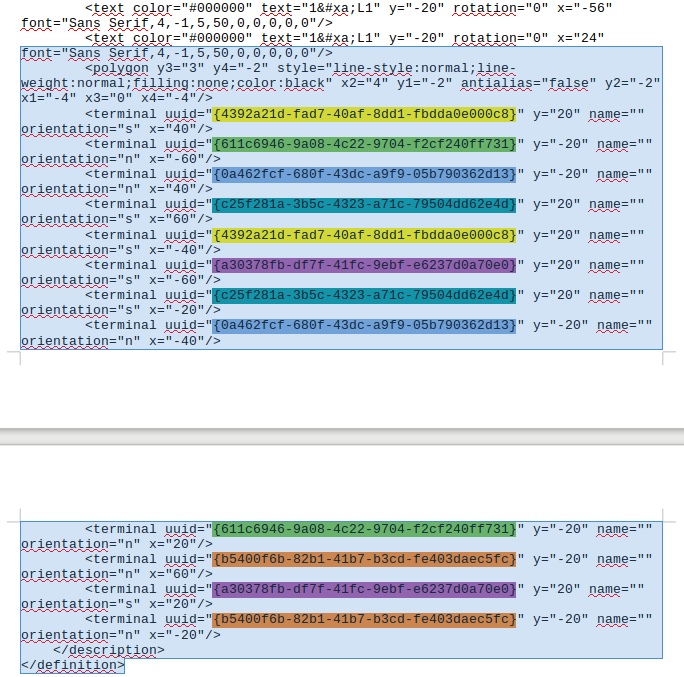

Hello,
each connection is given its own identification when it is inserted into a symbol. With your symbols it looks like the connectors have been copied and then pasted because the identifications are duplicated. As far as I know, this problem has been fixed (current version).

Hello,
symbol opened with a text editor. The colored lines are the connections. Using the colored markings, you can see that identifications are duplicated.

Hum strange, I though I was fixed this problem, may be a special case which cause the issue.
I see that.

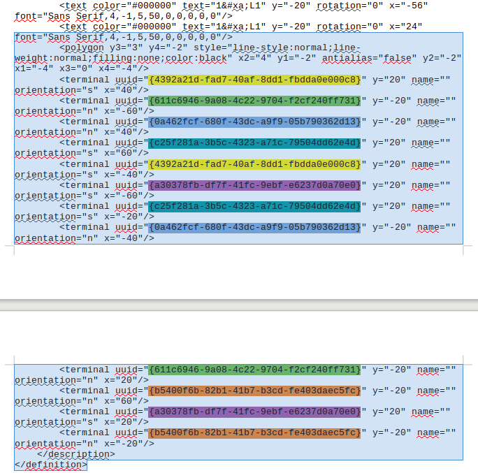

Hello,
symbol opened with a text editor. The colored lines are the connections. Using the colored markings, you can see that identifications are duplicated.Best regards

Indeed it is understandable
