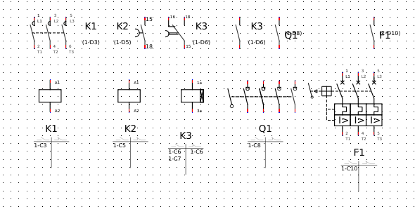

I met with some kind of bug on the contacts. If the contact is subordinated to the coil, then everything is fine, and if subordinated any switch or fuse, the link to the switch comes over to the text of the switch room. I tried to create a new switch with the button properties, but the problem still remains.
[img]kontact.png[/img]
kontact.png, 26.48 kb, 590 x 298
Re: Nouveautés de la version de développement 0.8
@Alexander:
change to
https://download.qelectrotech.org/qet/forum_img_2/alexander_xref.png

Thanks for the help. But the problem is strange. On the contacts from the coils when installed "bottom" shows the bottom. And on the contacts associated with the switches, the link remains on top. After the project is closed, these settings are not saved. I did not understand why it was necessary to share connected contacts with different objects. In practice, I have never seen such a separation. Even in pneumatics.
kontact2.png, 57.97 kb, 982 x 564
I saw the same issue on many config, change it in on general settings and also on your project.
