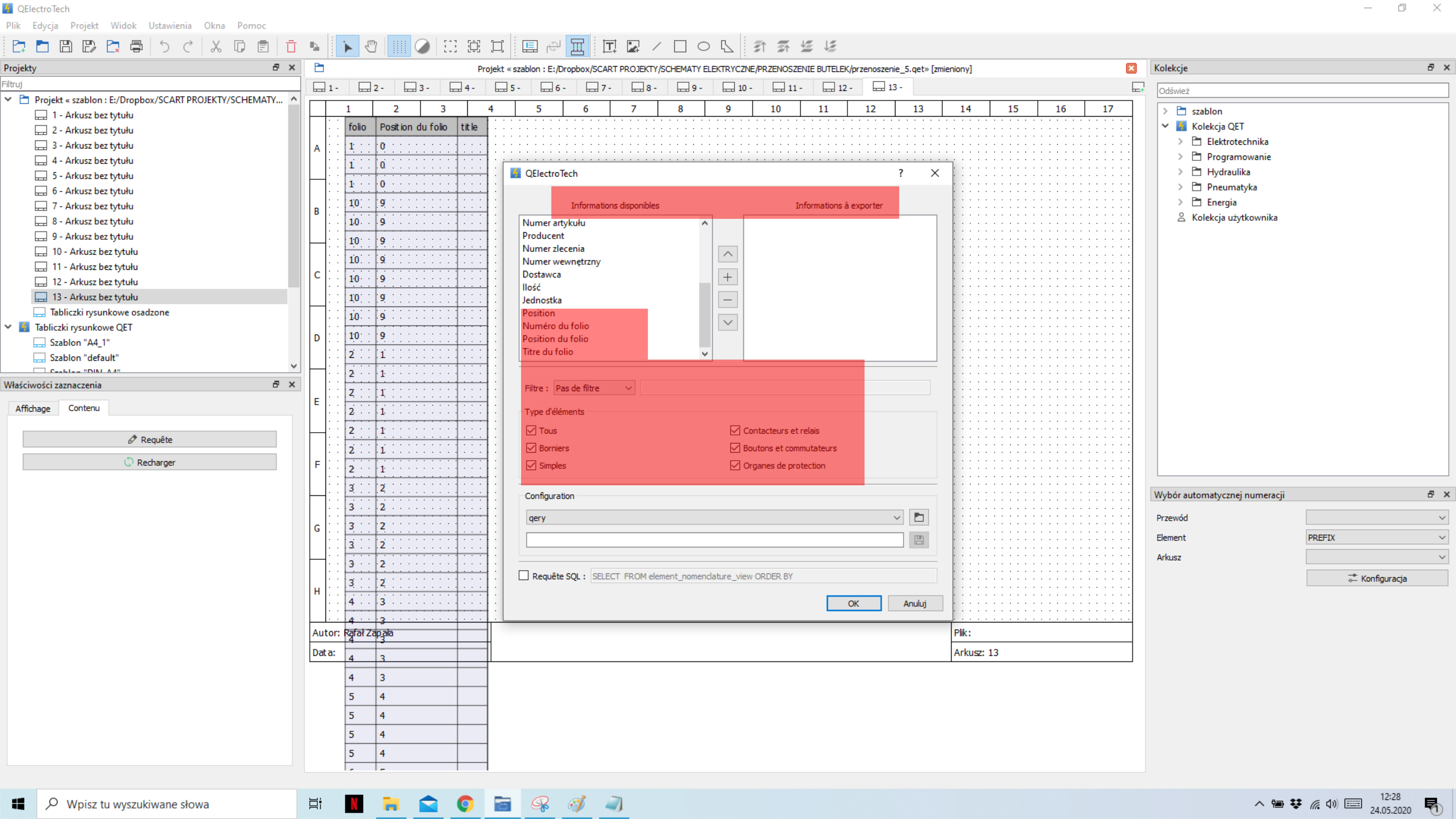

How can i change or add translations in nomenclature option window? Now i have polish and french texts.

Ok, i will try to help. I see that some of translations are already done, the only thing to do is mark them as done.
https://github.com/qelectrotech/qelectr … /qet_pl.ts
I made some translations. Also i found bug in nomenclature table headers. When i add folio number header, table show "folio" text instead of "Folio number" or any translations.

Yesterday it was translatable, i checked it, but today i made QET update to newest version (2020-05-24-2) and it stopped working. Interesting thing is that, when i make update in content, for eaxample disable terminal blocks, headers start to work properly.
