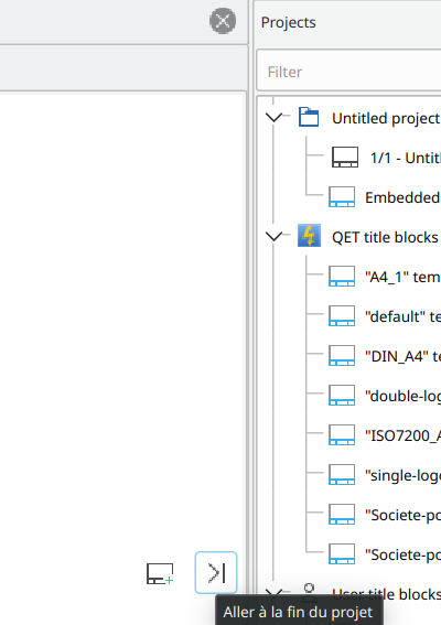

On the last version you can have quick navigation in your projects with |< & >| button in diagram editor.
https://git.tuxfamily.org/qet/qet.git/c … 6cda2f8893
https://download.qelectrotech.org/qet/forum_img_2/arrows.png
I started work but I had work outside and a lot of trees to prune, then I took advantage of the sun and the pool, Simon finished the job for your pleasure.
Thanks again Simon.
Enjoy! nomicons/wink

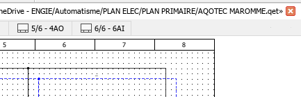

je viens de télécharger la nouvelle version sur windows
Capture.PNG, 6.14 kb, 433 x 140

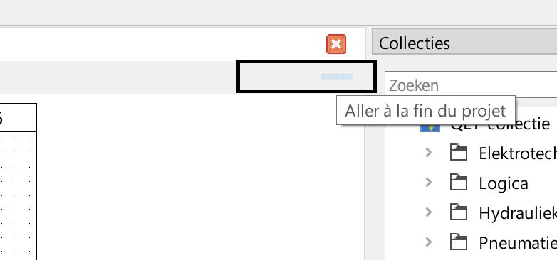

right, the windows gui is different this will require some adjustments.
as you can see it is there but there.
I'll make an effort to make it visible.
note: i am not equipped to work with windows.
temp.png, 18.58 kb, 782 x 366
