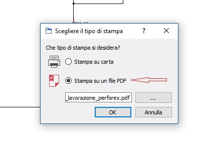

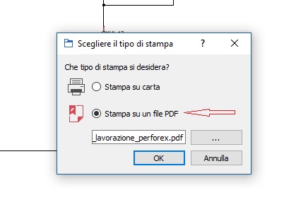

hi gentlemen,
i've a question for a default pdf printer
i try to find a command to change a print margins...
es. i need to put 20mm for a top margins beacose we use a preholed paper...but i can't move down a page from a top margins....where i'm wrong to do? or dosn't have a possible to set?

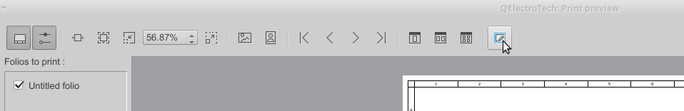

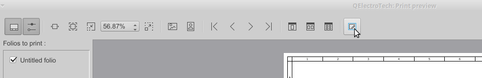

Hello elDrawer,
in the menu, click on File, then on Print and select PDF. In the print menu you will find a page layout option. There you can set the margins for the PDF.
Yours sincerely
Stebo

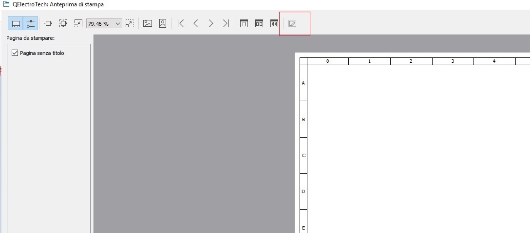

ok, thanks but when i use a "print on file PDF" i can't set a margins.
i can only if i use a "print on paper" and after set  a one pdf printer on my computer

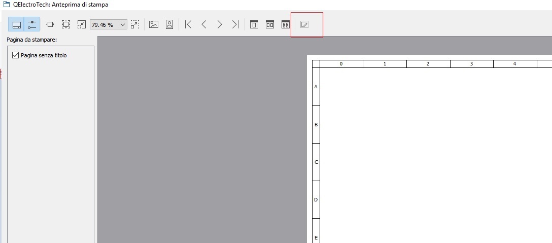

sorry but no, i can't...
i've do it but when i click on it dosn't open a setting page.....
