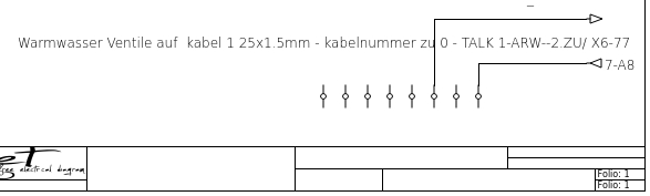

Sometimes happen that conductor's label is getting blocked and I can not move it freely (look at the pic attached). I was triying to move the yellow label to the left but the program does not allow me. Moreover other labels I had problems to move them freely up and down. Is there a way to solve it?

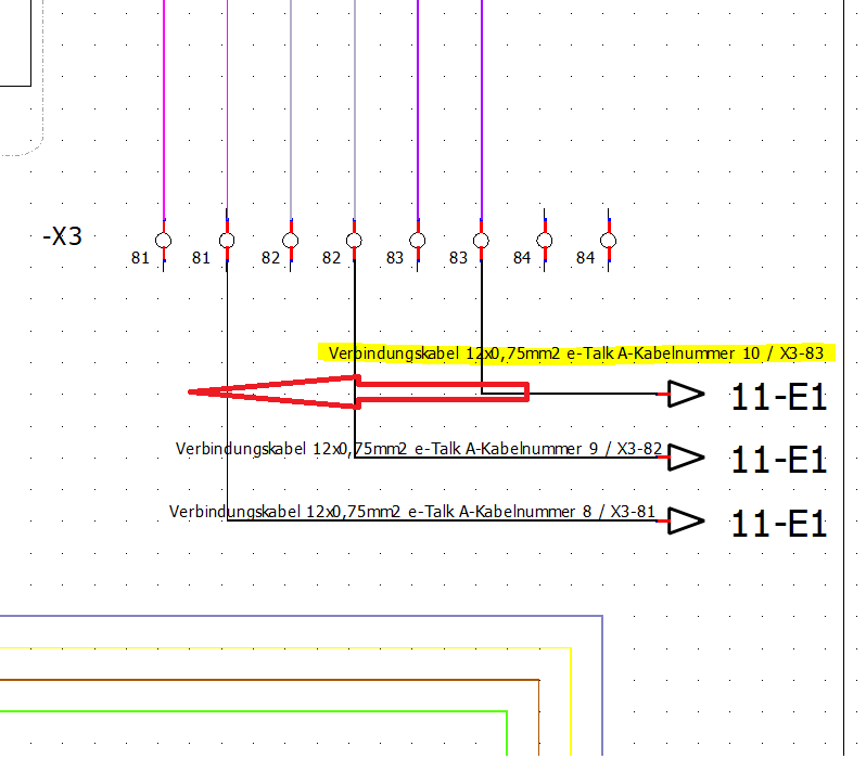

So there is no way to solve this, isn't it?

Re: Conductor's label blocked
Of course we can increase the limit value in the code.
But, not time this days to found this line code in this big program.

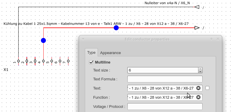

Hello leenk10
you can copy the conductortext into the field Function or Voltage / protocol.
The texts function or voltage / protocol you can move larger.
Best regards
Stebo
EDIT: The texts for function or voltage / protocoll must be assigned to the element for slide references in the editor because they are not present in the standard symbol.
Like this :

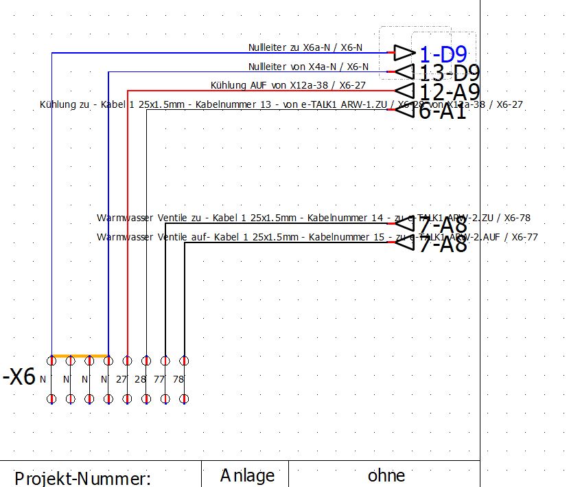

I am still having problems to fit the label in the sheet, could you fix this issue?

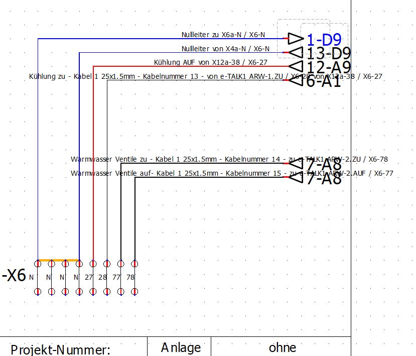

@McCormick
Your answer has happened too quickly.
The changes still have to be made by scorpio810(Laurent) or Joshua.
Have the source file retrieved from svn.
The changes made.
Compiles the program.
This is the result.
