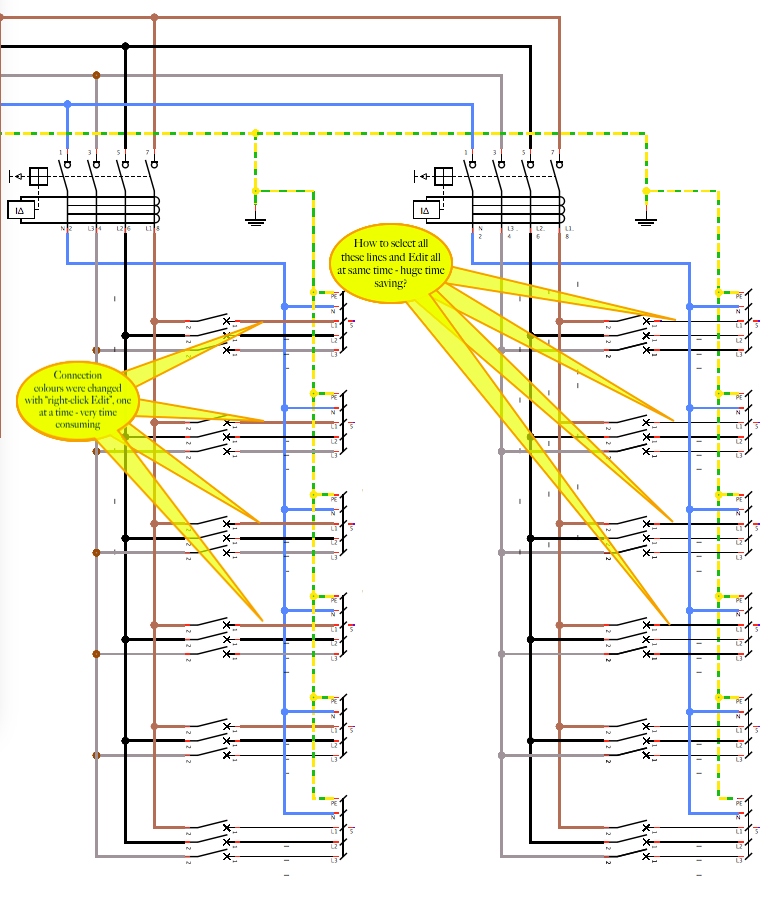

i'm new here. Been using QElectorech a few days now. Works ok so far. Doing my first Electrical wiring diagram with it for a house renovation.
Multiple connections between connectors on for example a data bus can be selected as a group on a MacBookPro with "cmd + Left-Click". Great.
Question: How can all the selected connections' conductors be edited all at the same time? It will save a heap of time.

Not possible with selecting multiple connections and richt-click Edit. Edit option disappears and only first connection is selected. See attached screencapture. Hopefully it explains it better.
Attachment icon Screen Shot 2018-07-29 at 19.31.22.png 142.56 kb, 360 downloads since 2018-07-29
Re: Multiple connectors Editing
It's not possible at this time to selct and modify all differents items in the same time.
