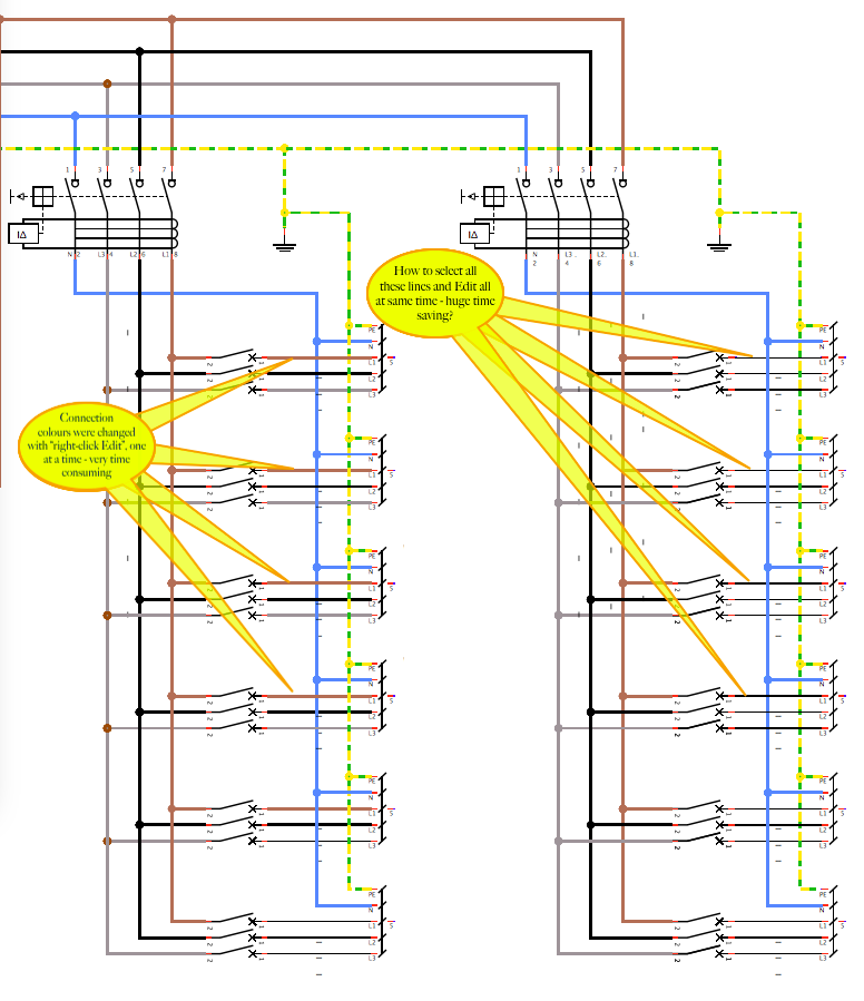

i'm new here. Been using QElectorech a few days now. Works ok so far. Doing my first Electrical wiring diagram with it for a house renovation.
Multiple connections between connectors on for example a data bus can be selected as a group on a MacBookPro with "cmd + Left-Click". Great.
Question: How can all the selected connections' conductors be edited all at the same time? It will save a heap of time.

Not possible with selecting multiple connections and richt-click Edit. Edit option disappears and only first connection is selected. See attached screencapture. Hopefully it explains it better.
Screen Shot 2018-07-29 at 19.31.22.png, 142.56 kb, 776 x 899

It's not possible at this time to selct and modify all differents items in the same time.

With shorcut F2 when conducteur is selected you can change quickly the color of one conductors selected:
This whole part of the code needs to be reviewed if you want to change the colour of several selected conductors in the same time...
https://github.com/qelectrotech/qelectr … ew.cpp#L99
Re: Multiple connectors Editing
FYI, there may be another tool, not perfect for this use case, but:
Search and replace.
CTRL +F go to option button with select conductors, uncheck all folios, select the folio you want to edit conductor color, select label conductor you want to change color, on the widget choose the colour field, select a colour.
