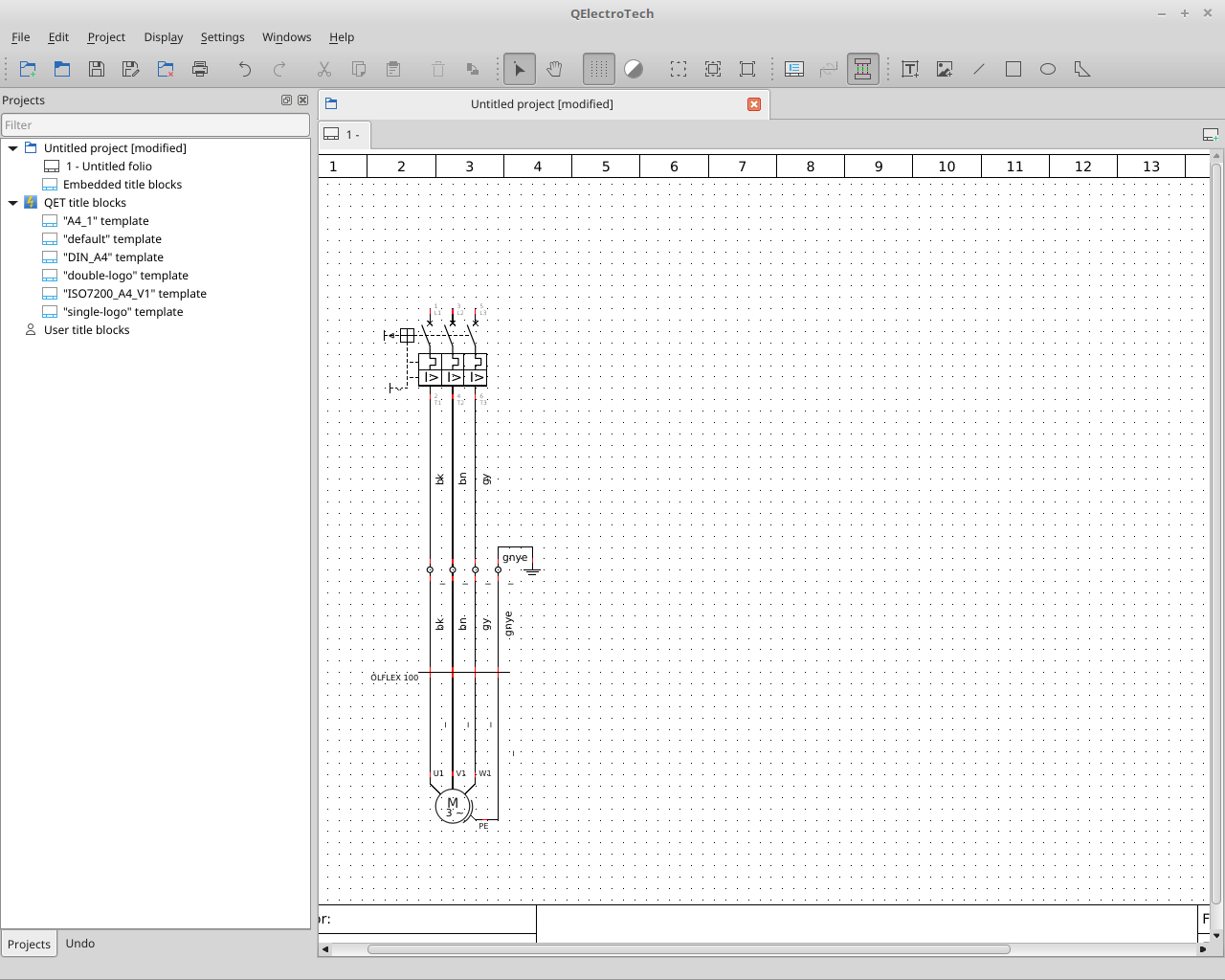

I am facing some problems with terminals and cable symbols.
As you can see, the core colors are copied automatically for both sides of the terminals. This is not correct. The cable in my case has numbered wires. When I change them, the cores in the cabinet are changing as well. The same is true for changing them from solid line to dots.
This copying of properties of connections through the terminals is for me unwanted, but I would like to see it in the cable sign. Unfortunately here the wire is interrupted and the properties have to be added manually.
- Is it possible to remove this property copying function from the terminals?
- Is it possible to add it to the cables
- Is is possible to add information to the terminals is the element editor for automatically giving cables doted lines?
Looking forward to receive an answer on these questions.
Bastiaan

As the conductor connected to a terminal block are at the same potential on both sides, the properties are propagated in every conductors of the potential.
In your case, this behavior is not the better.
Yes when you change the properties of a conductor, uncheck "Apply properties to all conductors of this potential" at the bottom of the dialog.
No, unless you change the "element type" of your conductor to terminal block, but by doing this, every terminals of your cables will be seen as be the same potential.
No
For your initial problems, you can copy the terminals element to your user collection, and edit it for change the element type to "simple" instead of "terminal block".
