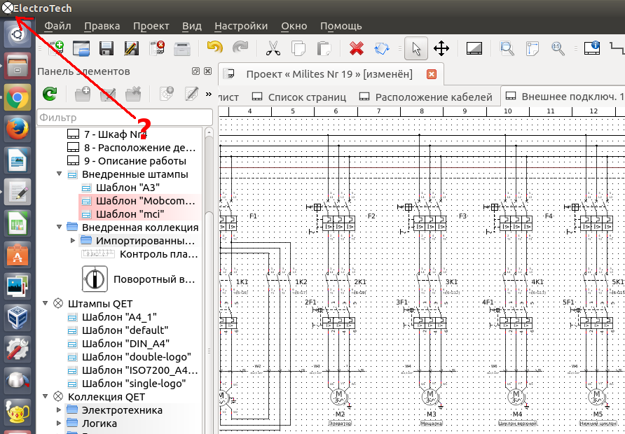

Thanks for realization of cables. It turned out better than I expected. Unfortunately on Ubunta 0.5 version didn't manage to be put. QT >=5.4 is necessary, and at me is established 5.2, and didn't find as to update.
Re: QElectroTech v0.5 beta released
If you use LTS Ubuntu version you could add this  unofficial PPA to have Qt 5.3.
deb http://ppa.launchpad.net/packetlost/qt-opensource/ubuntu trusty main
And use my Debian backport repository for Jessie , Qet is build with Qt 5.3:
deb http://debian.qelectrotech.org/qet/debian/ stable main
Use the latest Qt version is better, when you can !
For Ubuntu 14.4 can not find a public key nomicons/sad
http://ppa.launchpad.net trusty Release: The following signatures could not be verified because the public key is not available: NO_PUBKEY D412D6795858D2CE
Is QET repository key you want?
http://qelectrotech.org/wiki_new/doc/in … _depot_apt
Yes, everything is made according to the instructions.

I could not find how to get a public key
Tried on a virtual machine of Ubuntu 15.10, it all works. I would like to start a stable system.
D412D6795858D2CE is the public key to https://launchpad.net/~packetlost/+arch … opensource
[19:55:37] laurent@debian:~$ sudo apt-key adv --recv-keys --keyserver keyserver.ubuntu.com 5858D2CE
[sudo] password for laurent:
Executing: /tmp/tmp.XABiVpLZse/gpg.1.sh --recv-keys
--keyserver
5858D2CE
gpg: demande de la clef 5858D2CE sur le serveur hkp keyserver.ubuntu.com
gpg: clef 5858D2CE : clef publique « Launchpad PPA for remi poittevin » importée
gpg:       Quantité totale traitée : 1
gpg:                     importées : 1  (RSA: 1)
pub   4096R/5858D2CE 2014-10-16
uid                  Launchpad PPA for remi poittevin
Everything worked! Super!
Now the details.
The key to the link I have not found. But the script to make the key will return results. The public key has been accepted.
But polycy didn't show it. I tried to install Qelectrotech, only installation of Qelectrotech pulled with itself libqt5core5

The first test launch.
There artifact ...
qel-5.png, 179.98 kb, 892 x 620
I think, this it better integrate in latest Ubuntu 15.10, isn't it?
