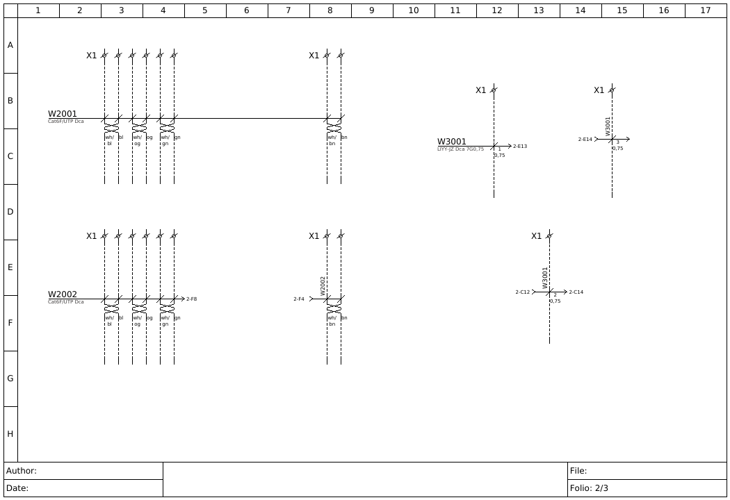

For making things easier with selecting cable's I was thinking of making a Cable database. Here the cables and cores are defined. Something like this:

When running the script each first core with cable-label will be searched for to find all different cables. For each label (W1001, W1002 etc.) a cable can be chosen from the cable database. The connected cores to the first core symbol will be filled automatically with the correct label. The cable data will be inserted in each core symbol.
Does anyone have an available script for starting with these XML searches?

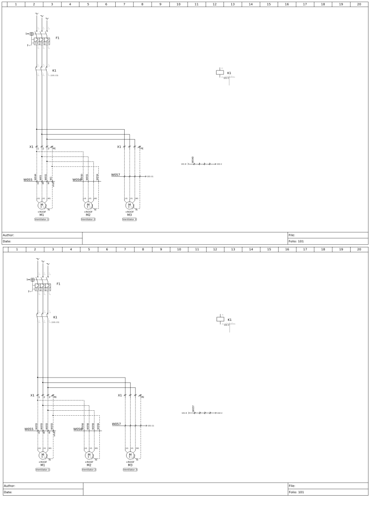

Here another example of how core symbols are used to define cables

I made a script with help of the "qet_tb_1.0.2.alpha"-script to auto-number cables.
A cable is made up of a "terminal-label"-element which is placed in front of some core-elements. (The standard "Wire of cable" or "Wiring" elements can be used or any self made symbol starting with "wire_" or "cable_" in the .elmt filename.
The cable-name from the "cable label"-element is by the script automaticly copied into the next cores, as long as they are on the same level and until they are stoped by a new "cable label" element or by a cable_referenct element or a cable-termination symbol.
These last symbols are self-made. You can find them in the sample project I'll post.
Cores that are drawn separately can be coupled by using cable-reference symbols.
The project I'll post has all kind of different information in the cable-cores. After running the script, all the core's get the right cable information.
