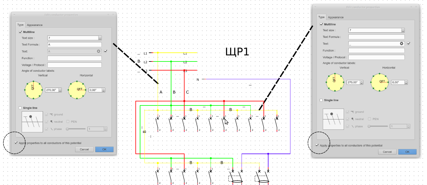

Hello polygon13,

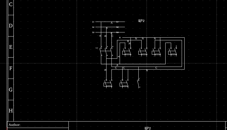

I have checked the connections, I noticed that some compounds have different properties (screenshot) and thought it might be because. First, I removed all connections and redrawn while I first drew a connection and assigned the property for this connection and further connected. Pages 2 and 3 of the DXF export has worked. After I have removed the connections on the 1 page and redrawed I had at the 1 page when exporting the same problems that the circuit was not displayed correctly. Funny is when I copy the circuit of page 1 and 2 on a new page or in a new project, the circuits after exporting synonymous no longer displayed correctly.

Hi, Calipso!
Thank you! Now I understand. But I did not specifically display tex on some lines, I marked them with color. Yes, I need to look for another export method or a screenshot and paste it into AutoCAD (((So now I'm doing it.
