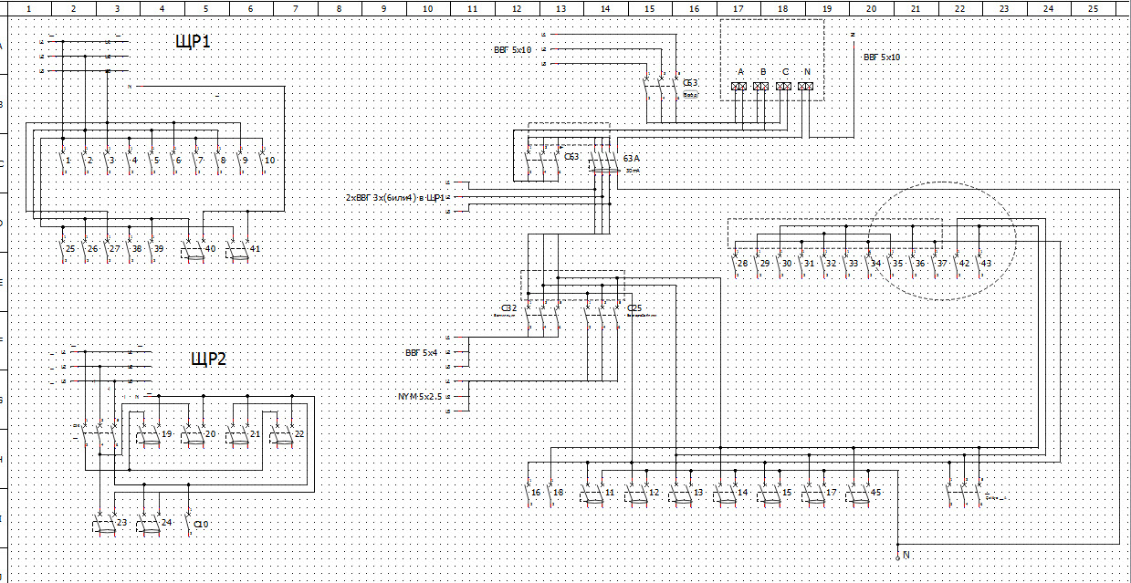

DXF export export does not work, or have I not set up something?
DXFExport.jpg, 486.62 kb, 1216 x 1917

Re: BUG?: Exporting to DXF - a "List of Folios" crashes QET
What your QET version?
[size=4]QElectroTech V 0.60
Компиляция: GCC 7.3.0 - built with Qt 5.10.1 - run with Qt 5.10.1
I tried it. No difference.

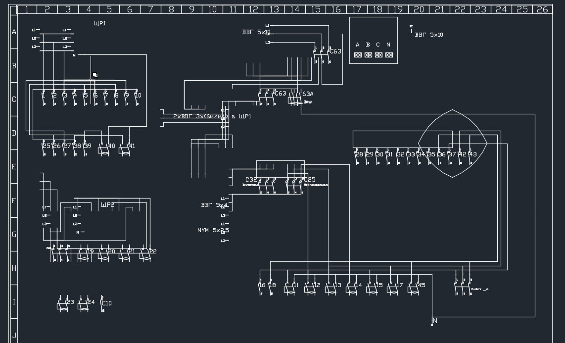

result:((
export_b.jpg, 113.84 kb, 1142 x 693

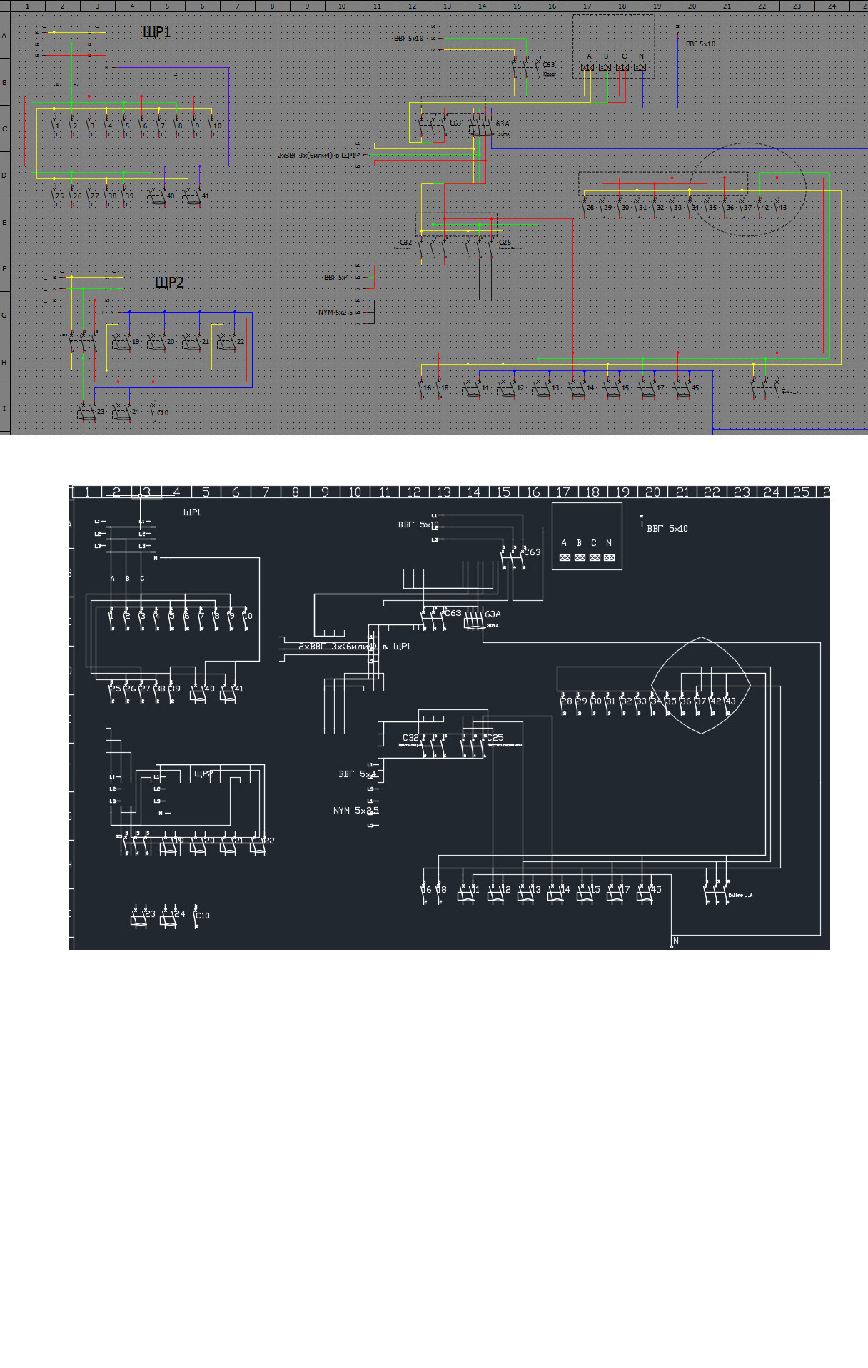

You could send this folio project, here?
I saw no problem here with arduino example :
https://qelectrotech.org/forum/viewtopi … 7873#p7873
