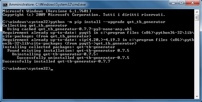

Re: Terminal Block creation Plugin don't work
Have you update script ?
https://qelectrotech.org/forum/viewtopi … 6786#p6786
16
Yes. I have the last version.
Verifica versione.png, 48.46 kb, 675 x 341
