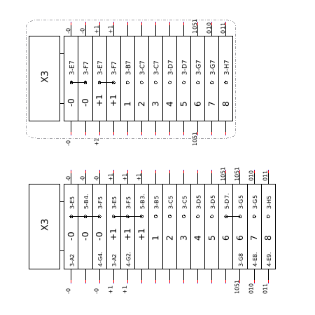

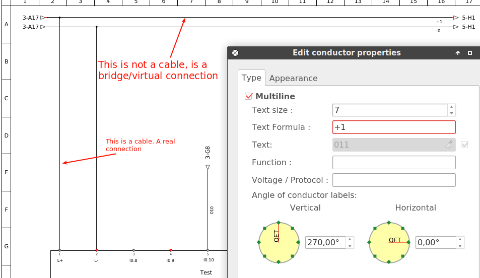

I've checked diferent options to implement teminal block in QET and maybe an option is allowing to define when a conductor is a bridge. Maybe adding a checkbox in the conductor properties dialog. This will be a easy way to create terminal blocks.

Hi, a new version 0.7.2 is deployed. Now for TB created with no searching implicit connections, the xref for the terminal is showed. A comment in the checkbox remembers the behavior.

The picture shows the differences between the TB:
