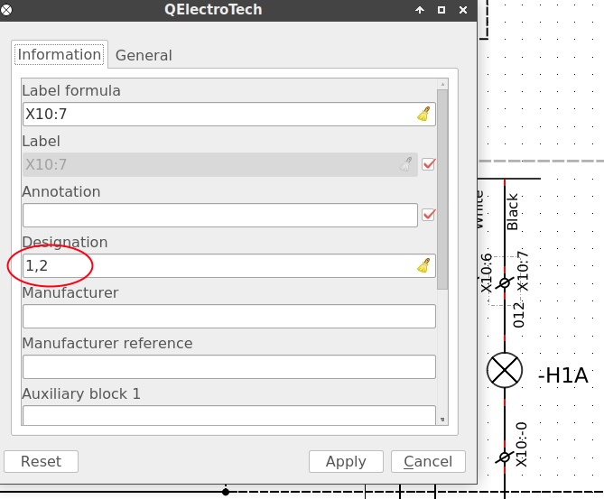

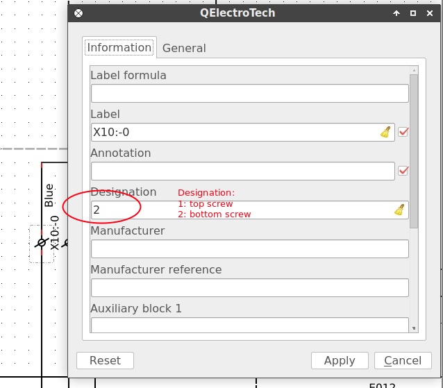

Hi, I'm Raul, the author of the Terminal Block Plugin.

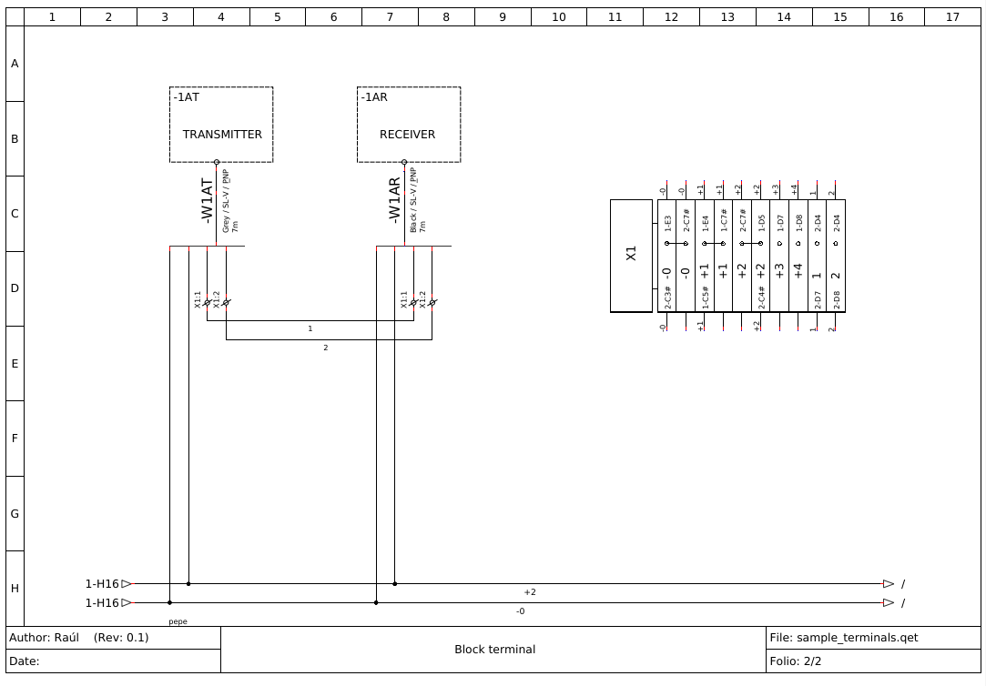

I'm thinking how to solve the bornier problem. The next picture show in 3 different colors, 3 differents situacions where the same element in the scheme represents differents real situations.
I'm thinking how to solve the problem to improve the plugin in later apply the solution inside QET.
I thougth to use the "designation" field to specify which screw represent every element in the schema. The script will check of 'terminal' type elements and checks it's "designation" field. According the info will draw the correct teminal block.
I don't used to use other electricical drawing software, so I dont't know how they solve this problem.
Possible solution for terminals connected to a common potential (bridge). You can specify the side where  the cable connected.
3 (edited by unalcalde 2017-02-15 16:28:21)
Solution for terminals the represents every connected cable (with the same conductor name or not).
You can specify the order of connected.
1,2 represents the  'black' cabled is connected on upper side and the cable 012 to the bottom
2,1: 'black' connected bottom and 012 up.

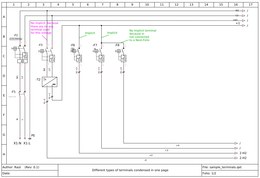

Here is a screenshot of the result for the new script termianl block creation.
The red and blue terminals are correct processed. Fer every terminal is respected the number pole where the schema defines the connection. Every standart terminal have 2 poles (1 for the north side or 2 for the south side).
Note than now every cable of the terminal block haves a xreference.
The scripts also search for implicit connections (in green). Search conductors that have the same ''num" that any terminal and checks that its terminal_id_1 and terminal_id_2 are no connected to a terminal element. If not, is added to the terminal block. The problem is that the coordinates x and y of the conductor are peculiar. The implicit connectios ends by '#' in the terminal block.
¿Do you know how should I interpret the coord for conductors?

13 (edited by unalcalde 2017-02-20 13:43:17)
@[size=3][font=Verdana, Helvetica, Arial, sans-serif]scorpio810[/font]
If you have a cable with severals wires, it's better to connect all of his wires to the same side of the terminal block: NORTH or SOUTH.

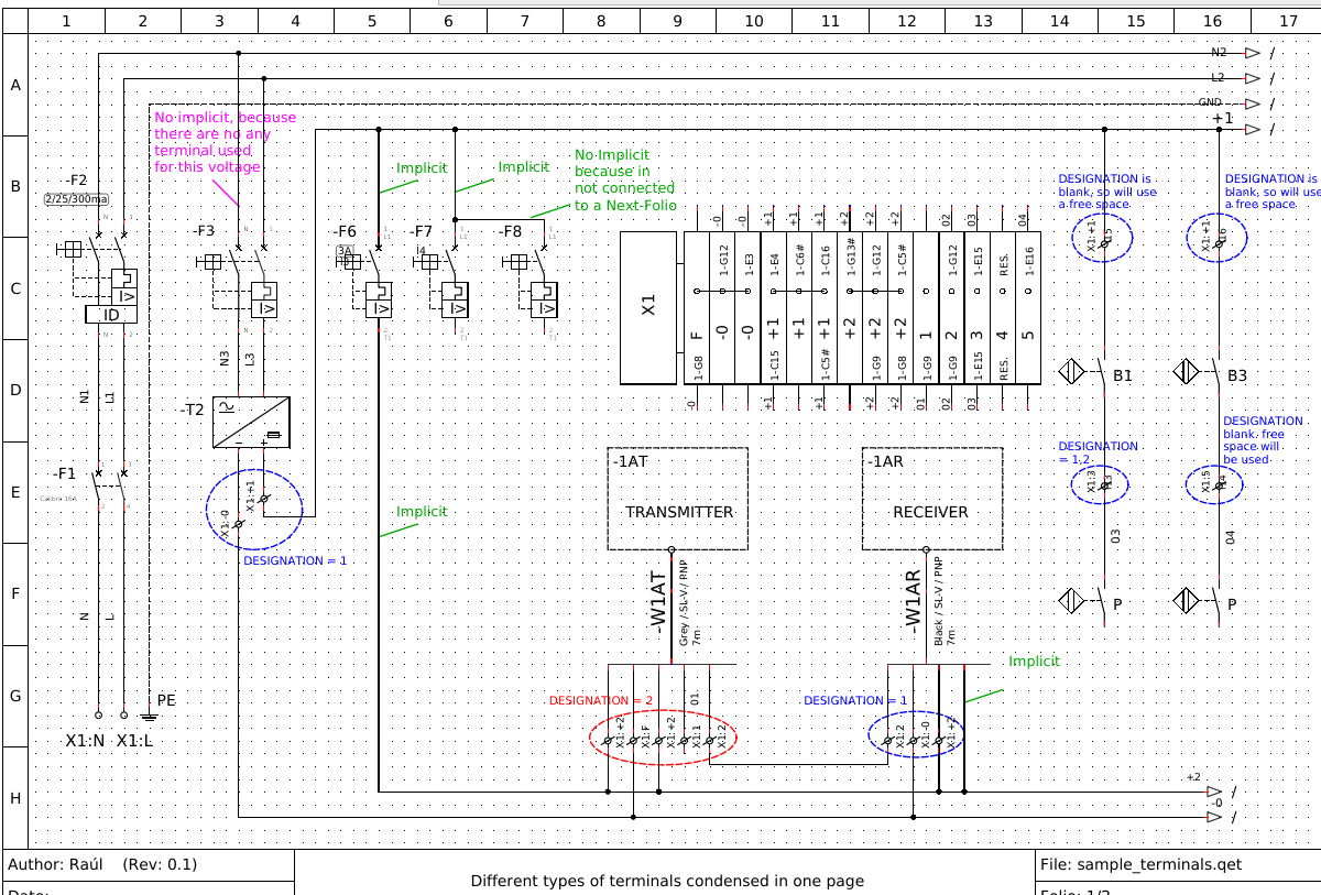

I changed the script, and now are considered implicit connection to a terminal block, conductors that:
  * one of its connections is to a "next_report" element (like 'next_folio' or 'previous_folio".
  * are not conductors connected to a terminal element (because was tracted as explicit)
  * is required that this voltage have at least one terminal element.
The image shows all posible combinations:
  * explicit terminals with blank in its 'designation' field
  * explicit terminals where we force side (1=north, 2=south) at its 'designation' field
  * terminals that are in the middle of a conductor (designation = 1,2 or 2,1)
  * implicit connections
For implicit conection, at the terminal block, appears the xref for the conductor side not connected to "next_folio" element.
We showld test the script, and when it works, we've the algortim that solve the problem, and will be easy to implement at QET. Can you give me some QET project to I check the script?

I don't understand. In other software, how do you say at what terminal strip belongs every terminal?
With the actual script, specify in the "designation" field where is connected is optional. If you don't put it will use a blank space or create a new one, but if you specificy 1 or 2 it forces North or South.
If we consider that it will be only a one terminal strip, I could search for all terminals, auto numerate and modify the XML of the schema with the data. Every terminal will have the same number that cables that are connected. Later search for implicit connections.
In a future, when QET can manage teminal strips, every time you place a terminal element, appears a contextual menu to choose at wath terminal stip is connected. It will be auto numbered as you place, and if is connected to an existing voltage, respect the numeration.
In project properties, a new tab allow manage terminals strips (add, delete, view components,...).
The same solution will be applied to cables with several wires. You need to specified cables, and when you draw a connection, specify if its a new wire of a cable.

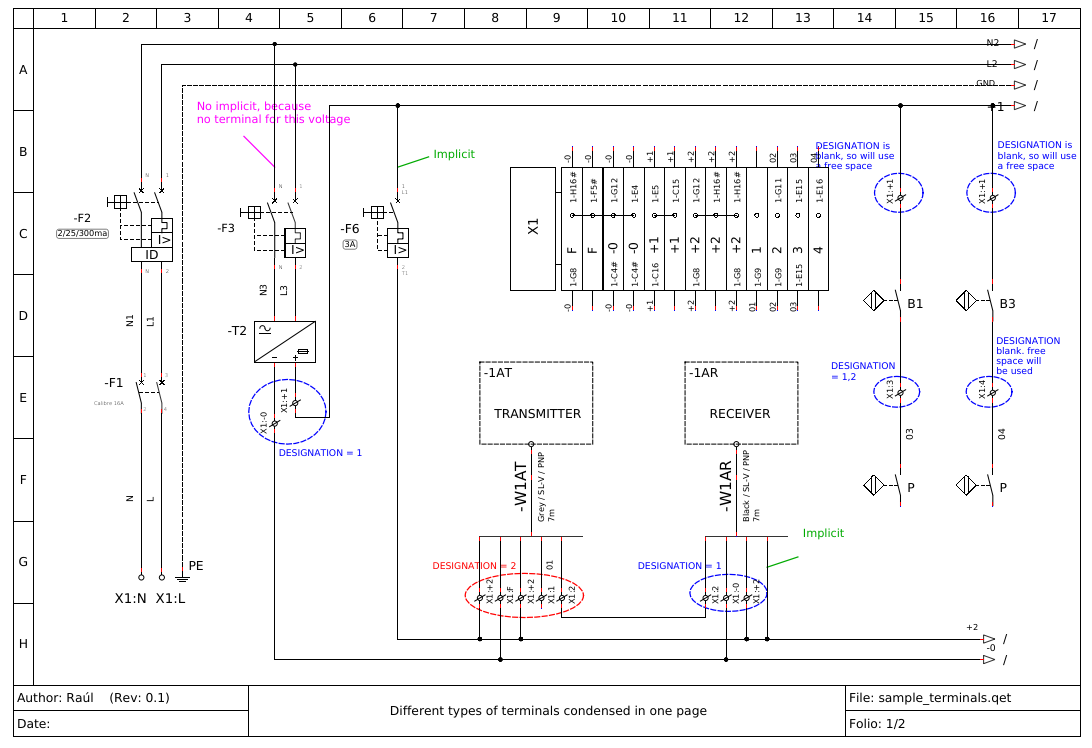

The pictures show the behavior when:
- the are only one terminal element for every voltage
- all terminals with a default config (e.g. no data on "designation" field for terminals element)
- multi page
18 (edited by unalcalde 2017-02-21 02:17:52)
(image 2)

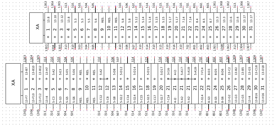

New version of QET_TB_Generator 0.6.4 is available.
Update with: sudo pip3 install --upgrade qet_tb_generator
Now there are a new TAB with helpfull information about requirements to use. This version searches for explicit and implicit connections to a Terminal Strip.  The implicit connections ends with ' · '.
Check please, to fix all problems and finally have the algoritm than solves the problem and incluide it to QET.

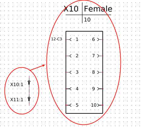

May be the next step will be to find the algorithm to draw a summary for CONNECTORS:

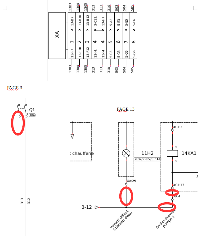

Thank you so much Raul ! nomicons/smile
I have test terminal module.
Xref are strong on terminal: are diffrent on the top and the bottom.
Module add some terminal with link (numbers 12, 21) but I don't know why.
Project file ....
23 (edited by unalcalde 2017-03-11 18:22:38)
Hi Galexys, the Xref ending by a point are found as implicits connections. Later I'll test your QET file and check why.
In previous versions, the xref refers to the terminal, and now refers to the connected element. The up and down connections depens of the orientation of the terminal in the diagram. If rotates, will change on the terminal strip.

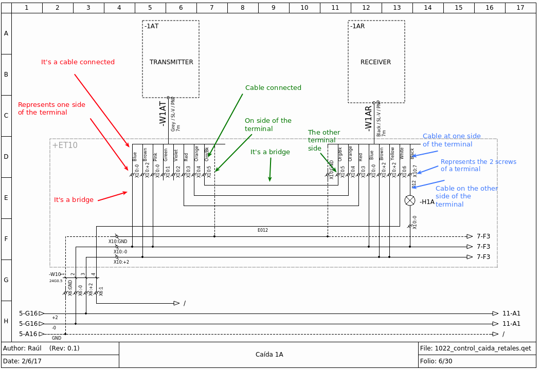

I 've implement a "Connectors" option. In the picture, shows that drawing the red part, we obtain the connector on the green part.
Could someone recommend me a diagram software that I can check to see how it implements  "Block terminals" and "Connectors"?. I need to see some ideas to implement the algorithm yet implemented in QET.
