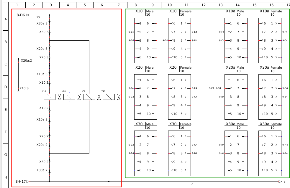

Here is a screenshot of the result for the new script termianl block creation.
The red and blue terminals are correct processed. Fer every terminal is respected the number pole where the schema defines the connection. Every standart terminal have 2 poles (1 for the north side or 2 for the south side).
Note than now every cable of the terminal block haves a xreference.
The scripts also search for implicit connections (in green). Search conductors that have the same ''num" that any terminal and checks that its terminal_id_1 and terminal_id_2 are no connected to a terminal element. If not, is added to the terminal block. The problem is that the coordinates x and y of the conductor are peculiar. The implicit connectios ends by '#' in the terminal block.
¿Do you know how should I interpret the coord for conductors?
004.png, 89.52 kb, 1092 x 748
Hi Unalcalde,
I saw quickly, but I think upstream and downstream screws are mixed, no?
You could add numbering into conductors in your diagram and draw your cables in Block terminal?
13 (edited by unalcalde 2017-02-20 13:43:17)

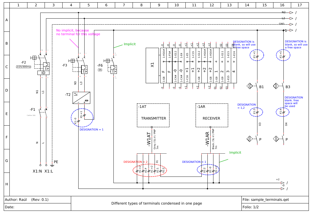

@[size=3][font=Verdana, Helvetica, Arial, sans-serif]scorpio810[/font]
If you have a cable with severals wires, it's better to connect all of his wires to the same side of the terminal block: NORTH or SOUTH.
I changed the script, and now are considered implicit connection to a terminal block, conductors that:
  * one of its connections is to a "next_report" element (like 'next_folio' or 'previous_folio".
  * are not conductors connected to a terminal element (because was tracted as explicit)
  * is required that this voltage have at least one terminal element.
The image shows all posible combinations:
  * explicit terminals with blank in its 'designation' field
  * explicit terminals where we force side (1=north, 2=south) at its 'designation' field
  * terminals that are in the middle of a conductor (designation = 1,2 or 2,1)
  * implicit connections
For implicit conection, at the terminal block, appears the xref for the conductor side not connected to "next_folio" element.
We showld test the script, and when it works, we've the algortim that solve the problem, and will be easy to implement at QET. Can you give me some QET project to I check the script?
005.png, 119.56 kb, 1200 x 813

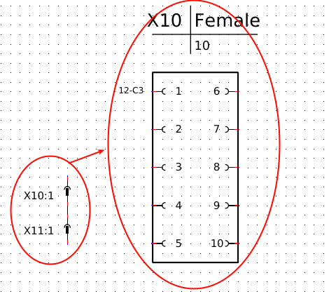

I 've implement a "Connectors" option. In the picture, shows that drawing the red part, we obtain the connector on the green part.
Could someone recommend me a diagram software that I can check to see how it implements  "Block terminals" and "Connectors"?. I need to see some ideas to implement the algorithm yet implemented in QET.
