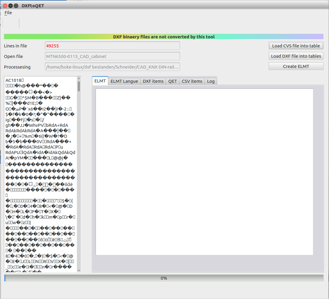

Notposible :
Binary dxf files are not converted by the converter
(schermafdruk49.png)
Work around :
open a binary dxf file in a acad or other program and save it back as a ASCII dxf file
Not posible for the moment :
dxf file full of blocks (we are working on this issue for one of the next versions)
Work around :
Open the dxf in a acad program, and save the individual blocks (symbols) into separated dwg files with the acad command 'WBLOCK'
then close your base file and open the files created with WBLOCK
save them as a ASCII dxf file and open these files with the converter

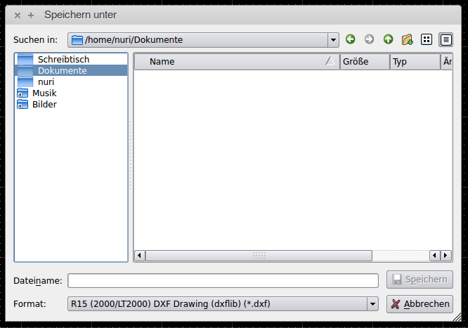

Now I can convert dxf to elmt directly from QCAD (dxf R15), without the need of Draftsight anymore.

@Karsten
I mean dxf R15 dxflib available in the options of QCAD as I choose "save as..."
