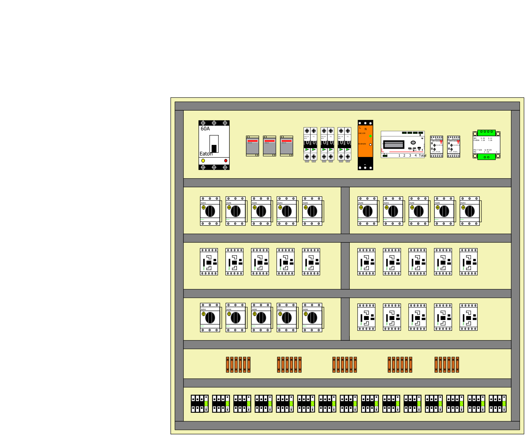

Im a new user or QET software and im trying to desing my mounting plate for my project but idk how to make it as a real size,
Im making my own elemenst and im using a enclouser size 1000mm x1200mm x300mm but idk how i can to scale or measure that size on QET coz i understand its codify on pixeles.
also im trying to read some post on the forum about that but i dont understand how to use the qet scaler, or where i can codify the codes that the pple post on the news.
If someone can helpme I feel greatful
HELP FOR WINDOWS 8.
1_esquema.png, 178.93 kb, 1815 x 1505

Hello Ernesto and welcome,
maybe see these:
https://qelectrotech.org/forum/viewtopi … 6411#p6411
https://qelectrotech.org/gallery/photos/nuri_schaltschrankaufbau_-_innenansicht.png
https://qelectrotech.org/forum/viewtopic.php?id=1592
Plc-user QET_elementScaler quick-guide, or see my videos :
https://qelectrotech.org/forum/viewtopi … 252#p20252
Search cabinet on forum search, for more informations.
https://qelectrotech.org/forum/viewtopic.php?id=2150
https://qelectrotech.org/forum/viewtopic.php?id=1924
Regards,
Re: how to scale elements to real size
See https://download.qelectrotech.org/qet/e … index.html
https://download.qelectrotech.org/qet/elements_contrib/10_electric/biblioteca_qeletrotech_WEG/layout_painel/1.1_medidas/1.1_milimetro_tds/1.0_regua_tds_45_graus/1.1_Regua%2045%20Graus%20tds.svg
https://download.qelectrotech.org/qet/elements_contrib/10_electric/biblioteca_qeletrotech_WEG/layout_painel/1.1_medidas/1.1_milimetro_tds/1.0_regua_tds_45_graus/1.1_Regua%200%20a%20100mm%2045%20Graus%20tds.svg
https://download.qelectrotech.org/qet/elements_contrib/10_electric/biblioteca_qeletrotech_WEG/layout_painel/1.1_medidas/1.1_milimetro_tds/1.3_regua_tds_200mm/1.1_Regua%200%20a%20250mm%20tds.svg
